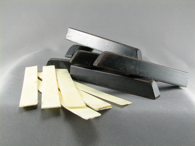

A friend dropped off ivory from the keys of a piano. We slapped a piece onto some very black ebony and turned it. It looked pretty good but I might try to diagonally segment it to flare the ends and expose more ivory.
Any ideas??
The ivory is just the key cover. Must be 1/32 inch thick. I already tried to glue it to Ebony and then turn it which did not produce good results. I am thinking about diagonally segmenting it. Gotta make that ivory SHOW somehow.
Try gluing it lengthwise. I saw a baton made that way... Looks kind of like a brick wall. It was beautiful. I'd love to try some. But every time I see an old piano somewhere, the keys are already gone.

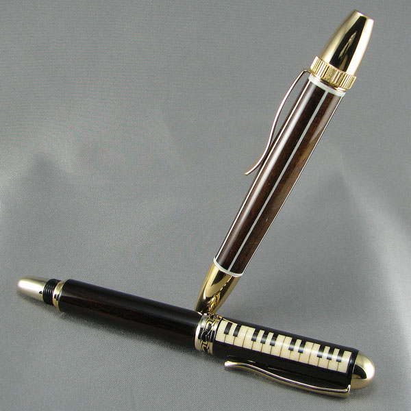

Here's a couple of pens I made for a musician friend. I got the piano keys from Verne here at IAP. They're from a 100 year old piano and yes, that's real ivory.
attachment.php
attachment.php
The pen standing up is the one made from the keys, the other one is the laser cut piano pen from Ken at Kallenshaan Woods.
