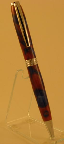

Ok i will try it. Pix 1 Carl

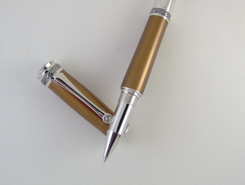

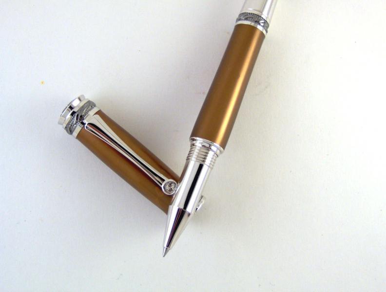

Here's an example of what simply adjusting levels can do for a poor photo (which I'm good at making) :biggrin:
Before levels ...
