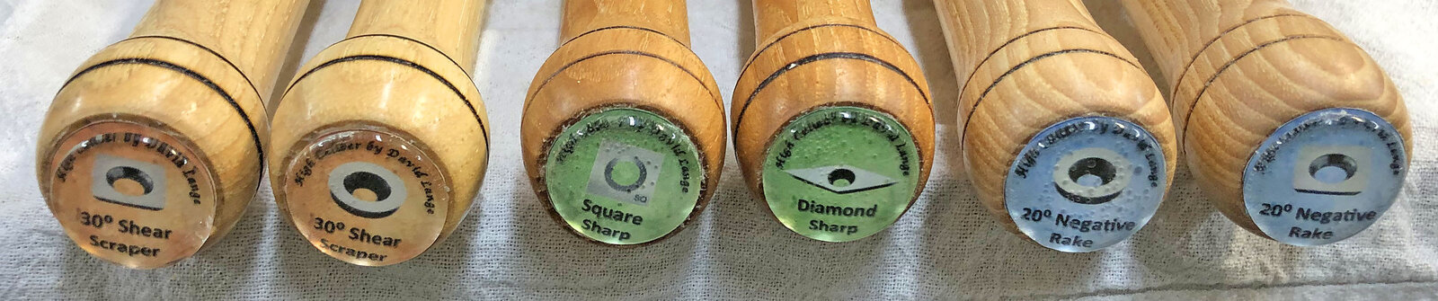

Most of the custom cabochon's I have turned out of work for the Legacy Jr. and Caballero kits measure right around 0.4 inches (10.16mm), so I have been thinking about buying a few 10mm cabochons from a jewelry parts supplier made colored glass, or stone like Rose Quartz. A while back I used 1-inch clear glass cabochons from our local Hobby Lobby store and an inkjet printed image to make the finials for the turning tools I made. Perhaps something like that but using smaller cabochons might work for pens too.
