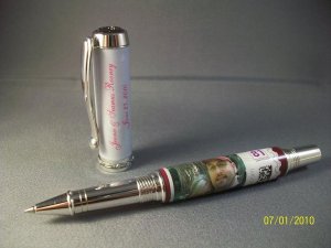

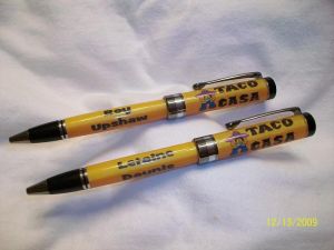

Don, love your work and all the sharing of technique you have done. If you have time, do you think you could post a pic or two of pens you have made using the method you described here? Russ
Thanks Russell. There are no photos but several label pens at the end of this article: http://content.penturners.org/library/pen_blanks/casting_pen_blanks.pdf
The labels are just pictures, right? Print a logo, a photo...they are the same and work the same. There is a picture of Mona Lisa cast by Bruce Robbins...
Seamus posted a picture of a couple of pens using avery labels also.
