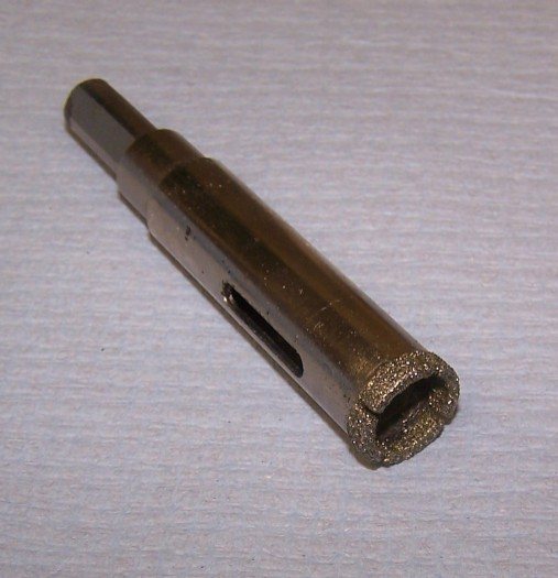

I'm afraid I don't have a clue either. But if I was forced to have a go, I would use a diamond holesaw like this one, for the hole. I have never seen smaller ones, but have been told they exist.This one is 10mm Dia. I used it's bigger brother to drill a hole through a mirror. I guess the outside would have to be ground too.
The other thing of course is that once you have made it, would it be recognisable and worth the cost and effort?

These bits will work. I would get a larger one matching the id to approximate od of the barrel and drill that first. Then like skiprat says, core out the inside with a smaller diamond drill bit. Grind with a diamond stone to final shape/dimension. I made this center band from Jade this way with shorter bits, but if you have longer ones it will work. The jade is probably just as hard if not harder than petrified wood. I bought a set of 6 1" long bits on ebay for $21 total including shipping. I'm sure you can get some longer ones for not much more. May also need a diamond coated saw blade to cut, but those blades aren't hard to come by either for a few uses.
