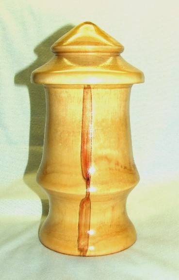

This is a lidded box I turned recently... LOML keeps telling everyone it would make a great pet urn... it's about 9 inches by 4 3/4 inches diameter.

I forgot to mention that you need to allow roughly a cubic inch per pound of live body mass.
