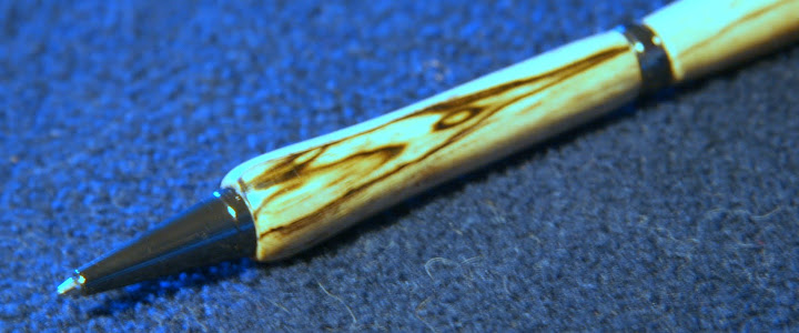

I have several friends with both arthritis and carpal tunnel. The pen they like the best has been a soft grip that I turned without the grip with a bulb at the nib end. This is a picture of a slimline I turned that way. The soft grip pen is larger in the barrel and the knob was larger than this.
