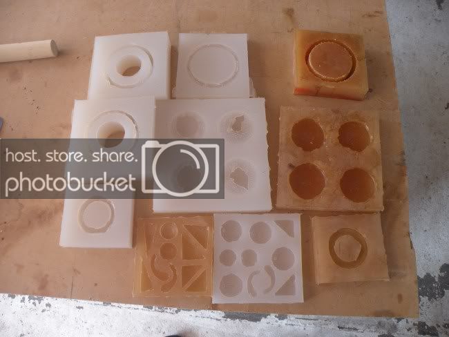

I made myself four pendants out of wood and cast them in silicone rubber to make myself a mold. This way, when I mix up multiple colors, I have enough room to pour it all without any waste. I also made bracelet molds and earring molds so that I can make sets. With all of these, once the piece cures in the mold, I mount on the lathe and scrape smooth using a skew and go right to sanding. There is almost no waste at all. This is sort of a "Resin Saver" for jewelry casting.
