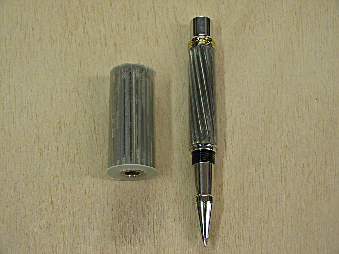

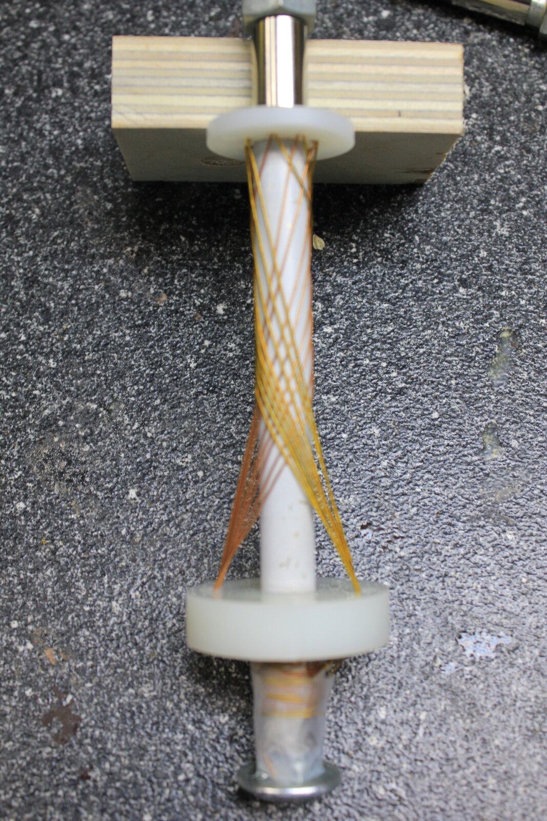

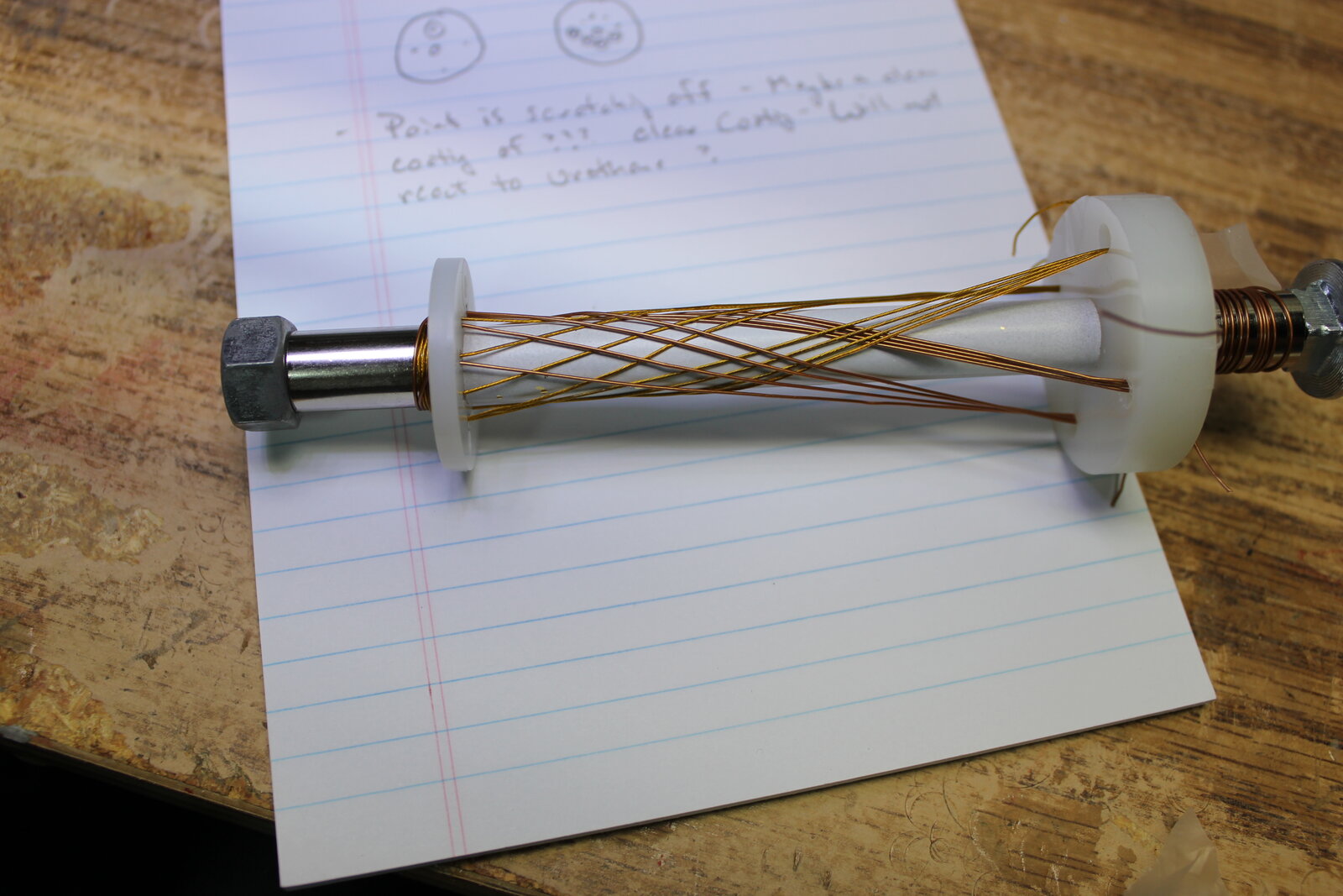

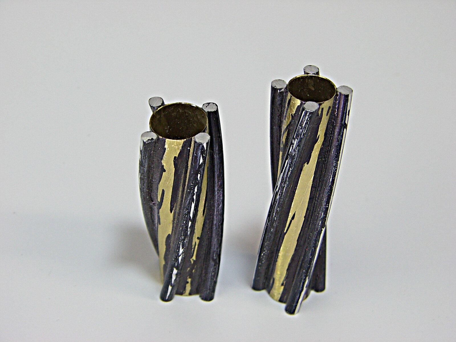

Love the work you are doing with the wire theme. Years ago I started to dabble a little but I just do not have enough time in my l;ife to complete all the pet projects I want to do with scrollsawing, woodworking in general and pen turning as hobbies. Now I have been working on my home for the past 2 years and still much to do so my shop time is limited. But every winter I try to get down there to do something. Here is a couple wire pens I played with. Maybe you would like to incorporate the idea some which should be very easy with the thinner wires you are using.
