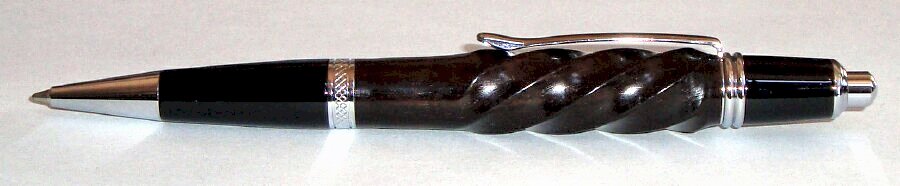

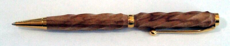

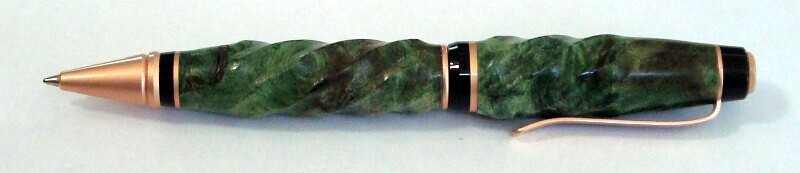

I'm sold on the Wiz. For me, it was a good investment that I'm having a lot of fun with. I especially like making spiral pens, like these:
Now that's what I'm talking about! Not that you want to make every pen the same way. But those are unique and interesting works of art. Thanks for sharing.
