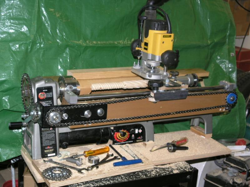

And there is a book by Jim Hylton named "Router Magic" that has a chapter on a home made router lathe that does some of what the Beale Pen lathe does.
Here is a link to look at. https://woodgears.ca/lathe/routerlathe.html
And this one. http://blog.pdxtex.com/p/router-lathe-build.html
Both are built on lathes, not an independent system like the Wizard, but both show the basic mechanisms that it takes to get the all of the "pieces and parts" to work together to create patterns. Another suggestion is to Google "router lathe jigs" and look at the images and research back to the sources to find other ideahy wastes. The "Router Magic" book that was mentioned also has good info.
You will need a right angle gear set, look at the right angle attachments for hand drills, hint buy the better one. They are sort of a good method to get right to left movement coordinated with the rotation of the blank. You will also need a screw axis, best location to find them is eBay and wait for the slow boat from China. I would suggest looking at the 3D printer axis stuff after you have researched it some, the axis screws and rails will make for a smoother transition than the other methods used in some of the research models that have been suggested.
Another suggestion, build it medium sized, trying to go small will just create more problems in the building process. You can make your own gears if you are building a medium sized version, but the tiny gears are harder to create as accurately. A good size is like the one that Don Ward, Its Virgil posted a week or so ago. Why waste hours, days and then months on making something so small it will only work on pens, make it large enough for other stuff.

Note it use belts and pulleys to create gear ratios. Belts will slip, where gears are only as good as the gear maker is. Making pulleys is easier than making a set of gears. If you go the belt method, buy some vacuum cleaner or sewing machine belts and build around them.
For DIY the book Router Magic by Bill Hylton provides some fairly detailed instructions for building a stand alone version of a router lathe. Several years ago I took some of his ideas and made a version that would attach to my lathe.
