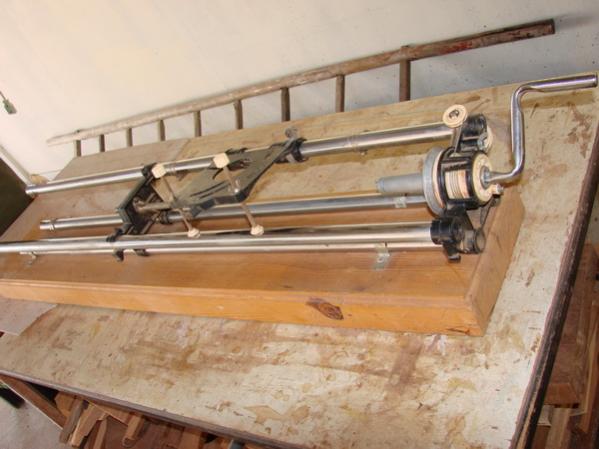

I wonder, (f you are old enough,) how many of you PW owners, realise that both Trend, in the UK, and Amersaw in the US of A both made a piece of gear, identical in its capabilities, as the PW, but much larger, and using a router? I have one, Shipped from the UK, and I have taken a photograph of it, it does Table legs, chair legs, and is able to do, flutes, spirals,( Twists) - left and right hand, and also Pineapple, on straight sided, and shaped preturned round stock. The Trend, was called A Router Lathe, or Router crafter, and the Amersaw, was called the Woodmaster ( which is the one I possess) Dontheturner.

Don, I could never understand why Trend stopped making those. Perhaps they were a bit 'before their time' :confused:
I know a few people with them and I wish I could get one at a reasonable price.
Hi Skiprat, Your thoughts, are then - the same as mine exactly. Years ago - more than I barely, care to remember, a friend of mine, and Architect, retired, and I then did a french polishing course with him, and he then got me to teach him to turn. As he wanted the same lathe that I had, I did some scouring, and found one, at the Shrewsbury Woodturning School UK. Whilst there collecting it, I saw & bought my Woodmaster from them, and paid £100 (which was four weeks wages!) My how time flies! -I reckon 28 years ago! regards dontheturner

I have one of those that I inherited from my Dad.
It is more of a smaller precursor version of the Legacy than a larger Pen Wizard.
My Dad made a lot of canes with his. He made a deal with the local Sears when they got shovels with broken handles they just sent back the spade portion and gave him the broken handle.
It is, however, the same principle.
