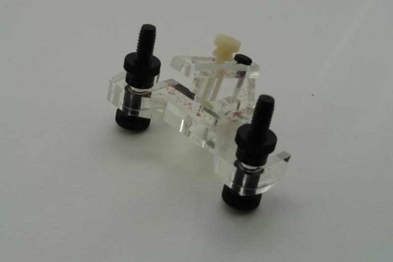

I have been working on the depth gauge situation and have come up woth a new improved model. It will work with any cutting tool including the Foredom. It bolts to the bottom of the mounting plate and has a fine adjustment which is much easier to use. It will be ready to sell next week and is $24.95. We will not be selling the old one any more.

Yes, it will replace the tube device and will produce the same results. We will have a video on it next week. It is not as simple, but it will work better.

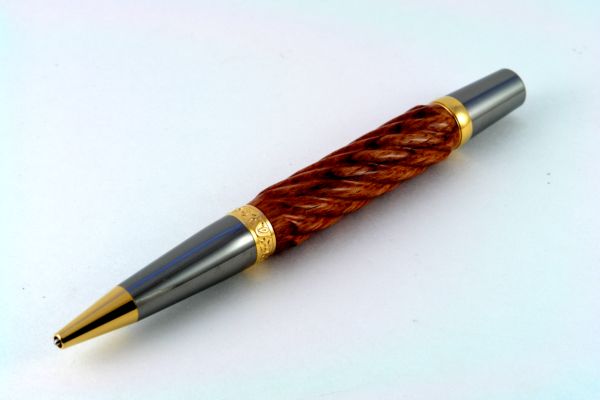

I don't have a video but it is done just like any other spiral. The picture shows one done with 8 passes and .35 turns per inch as shown in the instructions. It takes longer to finish because you will want to sand the grooves. The cutter cuts pretty clean though so it isn't too bad. I just folded some 320 for that. The finish is one coat of Danish oil and buffed.
