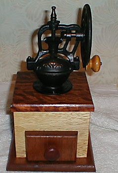

just put together the pen state coffee grinder kit (PKGRIND)
the box is african limba, top is bubinga, base and drawer front is mahogany and the drawer pull is purple heart(kinda went with the african hardwood theme"
That looks great, so it wasn't that hard? Have been thinking about picking up one of these as a gift for someone but wasn't sure. Are all the pieces already cut and you just put them together or do you have to cut the pieces yourself? Either way would be fine, just curious.
Thanks, Janet :)
thanks for the kind words everyone. the kit only consists of the grinder mechinisim..you build a box with a drawer and drill a 2 inch hole in the top..(I had a 2 inch chunk of limba and wasn't that impressed with it when I turned it so I cut into 1/2 inch boards and planed it down.) the grinder then bolts on the box.. there is an adjustment screw on the top to adjust the grind
