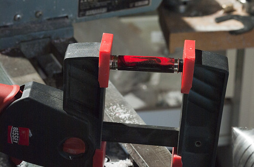

I used to use my drill press, but I saw a press used by pssherman that I copied. Mine is similar, but I modified it to be permanent and a little taller, whereas his was portable. I just bought a 1/2" pipe clamp from Lowes, and a 18" section of 1/2" black threaded pipe, and a 1/2" flange. I screwed the flange to my bench, and screwed the pipe into the flange. So I can easily remove it from my bench if I need too. The clamp has hard rubber feet on the jaws. The one I saw at HD didn't have these. All in all, it cost less than $20 & works great.
love that idea. i actually have a clamp in the shop i've been trying to figure out what to do with. this makes the work vertical which is nice sometimes when aligning, trying to hold applying a drop of CA and begin pressing. tough to do horizontal some times. (that gravity thing you know) think i might give this a try.

Thanks for the great idea! I have several pipe clamps that have been sitting for two years...since I'm not doing "flat work", I think I'll take one of them OUT OF THE PACKAGING and actually put it to use!
BSEA, Went to Lowe's this morning...set mine up just like you did, the only differance I drilled a small hole in the bottom plate for the nib to sit in.

There is always something you can do to make things a little better. One thing I'll be doing is getting a 24" pipe. That way everything will be at eye level.
Do you have a picture of how the nib sits in the hole? It seems to me like it would be metal on metal, and therefor might mar the finish on the nib. But I am probably not seeing it right.
