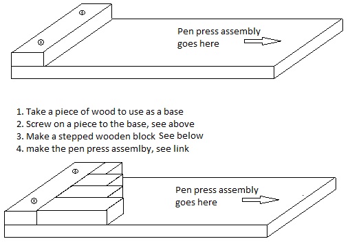

I use the Psi pen press but I know that guy that taught me used a wooden on that I like better I can draw up some plans and post them
