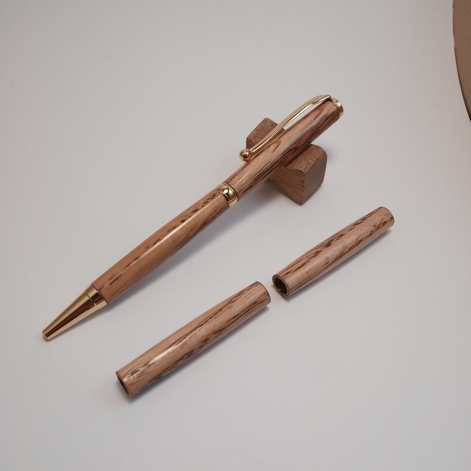

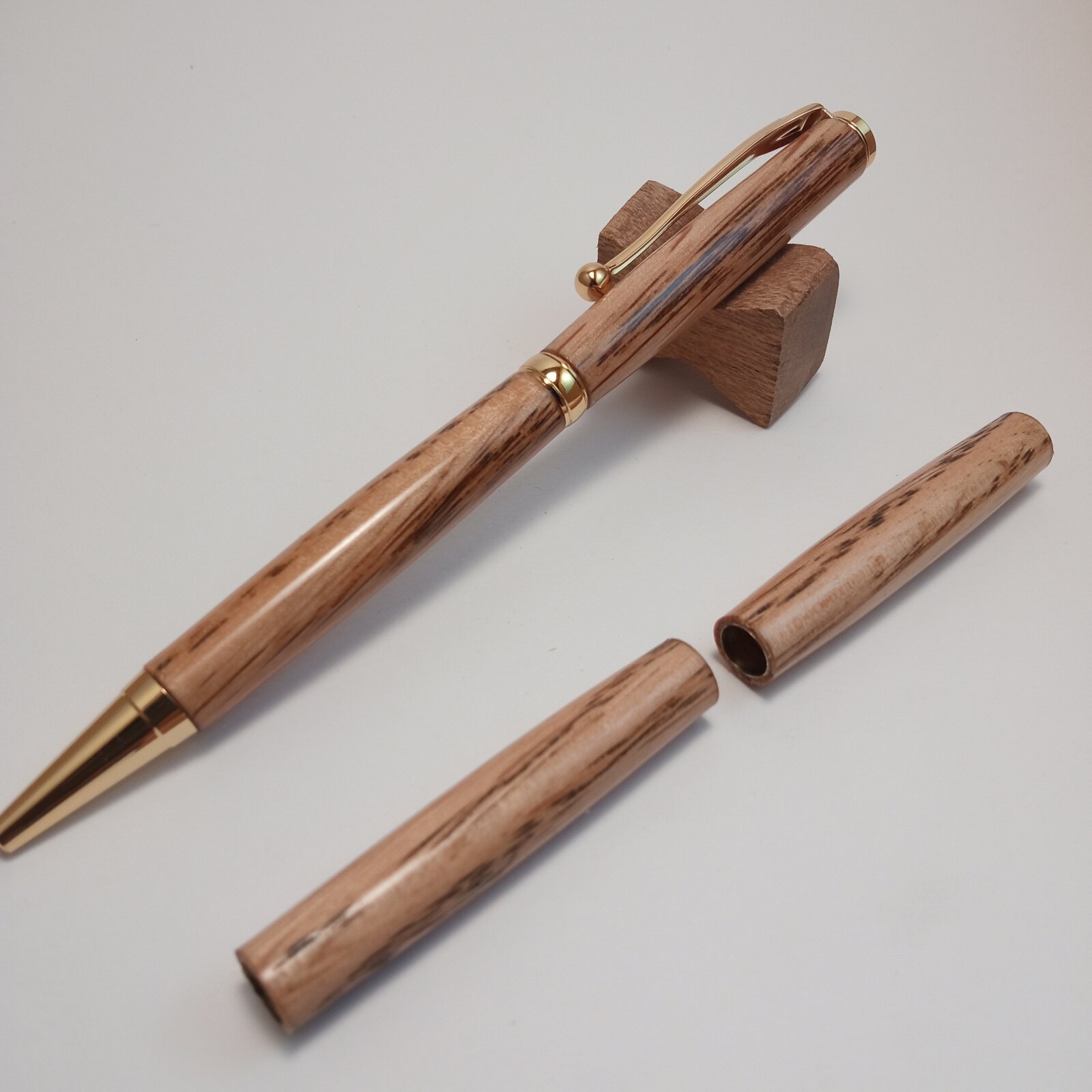

So after experimenting a bit with pens plus i managed to make this.
The pen at the left is finished with ca and the blanks at the right with PP.
Important note: photo taken with a crappy phone in a homemade lightbox.
Many thanks to everyone in this forum for sharing thoughts and expertise. Cheers
Looks pretty comparable. I think you can get the PP much, much shiner though! ;) With practice, you'll get better and better at using it.

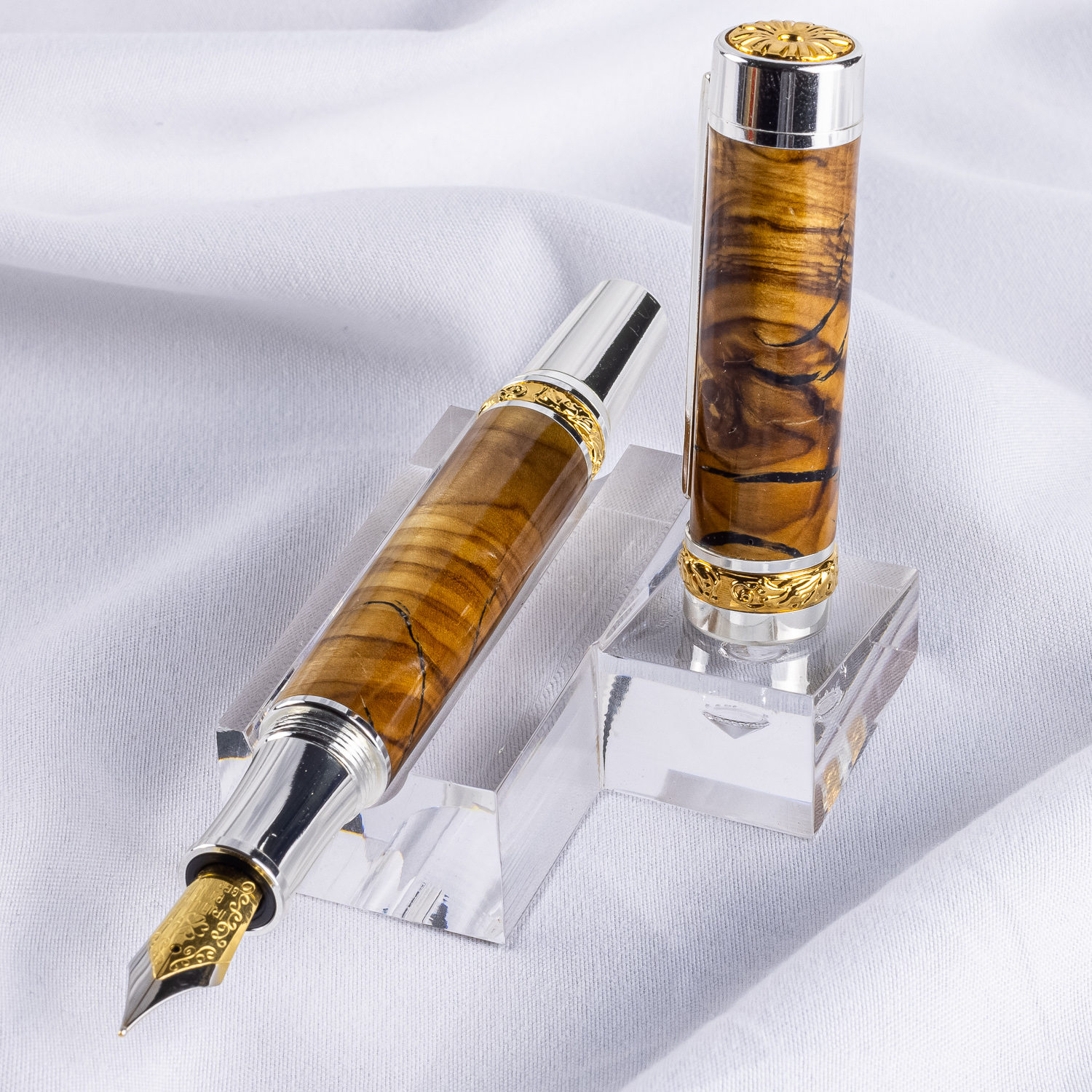

Beautiful pen! When it got here, I saw that it was clear. As a young boy, Mom and I would visit my grand folks in Missouri each fall during the teacher's meetings in Tulsa. Grandpa owned a walnut huller in town, and I would "work ha" with him and an uncle. I would always have dark walnut stained hands for a week or two. Great times growing up in the 50s & 60s.
