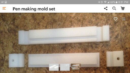

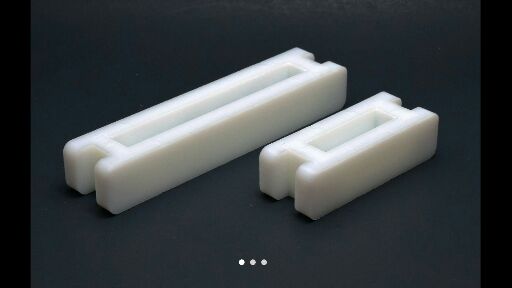

C CrashmanS Member Joined Nov 21, 2015 Messages 91 Location West Virginia Mar 31, 2017 #1 Anyone use a mold like this for casting blanks? Found it in etsy. Sent from my SM-N920P using Tapatalk
T Terredax Banned Joined Nov 1, 2015 Messages 892 Mar 31, 2017 #2 We used to make interlocking molds from UHMW plastic. If the rabbets and dados aren't tight fitting, resin will seep into the joints. It wasn't a big deal, the resin cleaned out pretty easily.
