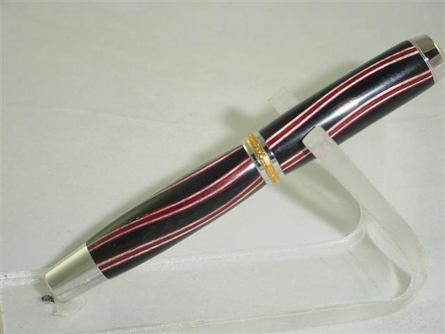

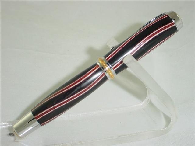

Due to the similarity of the pattern, perhaps this will give you more "visualization".
The pattern is really VERY unique. On the statesman, the threads engage every 120 degrees (360 divided by 3 times). Amazingly, since Eagle made the pattern repeat SIX times, the pattern "lines up" no matter where you engage the threads. As I look at the pic, I realize it LOOKS "off" a bit. This is, apparently, due to the camera angle or the pen may be slightly "unscrewed" while the "reluctant photographer" (the guy who never wanted to minor in photography) posed the pen!!
THIS WAS NOT part of my planning in choosing a kit!!!!! (I am NOT that smart!!! Remember our FIRST conversation on IAP, Ron??)
BUT, YOU may want to consider it, since some kits engage at FOUR points and some at THREE.
FWIW, Ed
