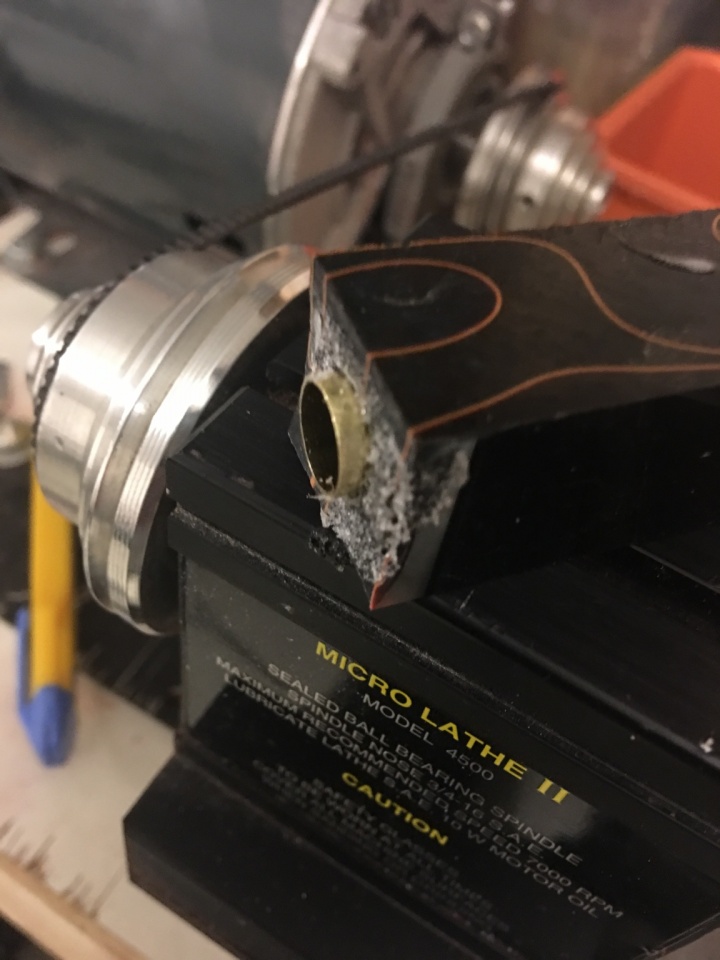

What should I do ? Is this garbage or it can be fix?
Please help! Much appreciated !

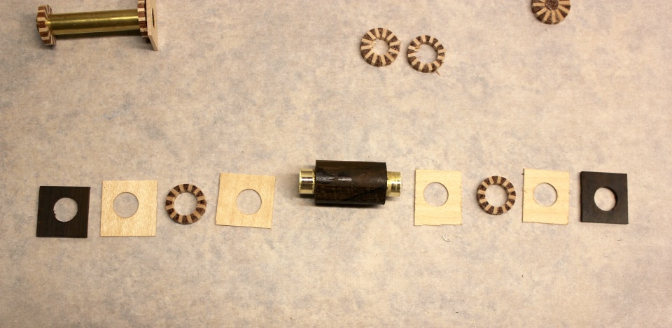

It can be salvaged. I'd first turn what isn't messed up round. Then I'd use a parting tool and turn . . oh. . . maybe 3/8" or something from the messed up end down to the brass tube. Then I'd root around in my bag of offcuts for an offcut in a complementary or contrasting color, drill a hole in it, and glue it to the tube and mating face.
I'd probably do the same on the other end, to keep symmetry.
"oops bands" are learning opportunities. You can pretend you meant to do that. Welcome to segmenting. :wink:

Thank you Brian
Much appreciated ! I'll give it a go !

Oh my yes!
Do exactly what Brian said - maybe add section from old credit cards. Just make sure you have a nice tight joint between the sections.
Have FUN!

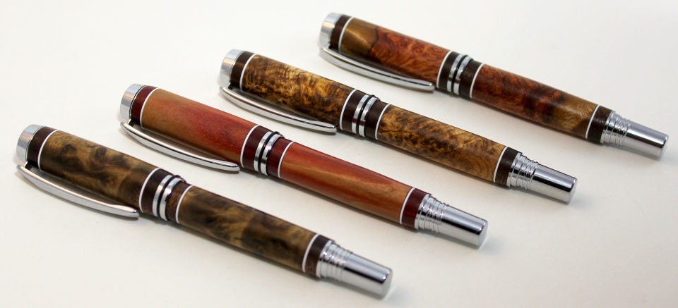

That is awesome! Thank you for your picture !
I'll give it a go!
