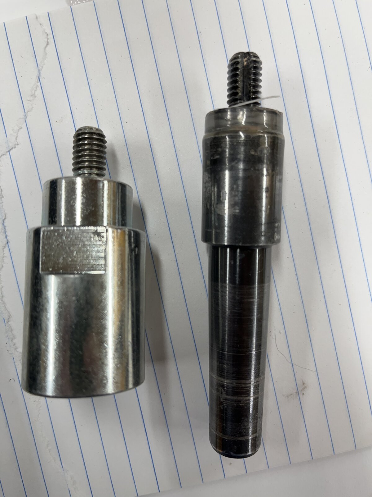

I'm not sure about that. I have a couple chucks and haven't found a need for them to be bigger… yet. With stoppers I use my threaded stopper mandrel that threads onto the threaded inserts.
Sorry, I wasn't very specific. I have a threaded mandrel that I use while turning,
I use my chuck to drill the blanks to install a threaded insert, sometimes my pen jaws don't open up large enough for a blank and I have to put my regular jaws on to drill.
Ok, I should have understood that. Yes, I've had that issue and had to trim it on the band saw to fit.
