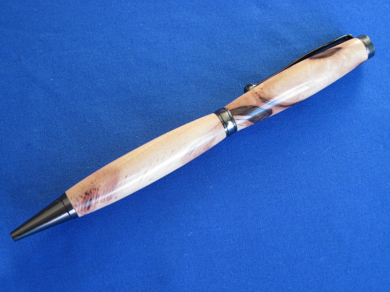

Here is a pecan slimline. I really like the way this wood looks, but it sure is hard and dulls the tools quick. I got a couple pointers on improving my CA finish that I implemented on this pen. What do you think of the finish?
I think you did an excellent job on both the fit & finish. I know I struggled at first with finishing. Now I just take more time, and I do it the same each time. I think that has as much to do with a good finish as anything. When you find what works, stay with it. . . . . . . . . . . Until it doesn't work. And that happens too.:rolleyes:
Derek, the finish looks fine, the shine line is the tip, it shows almost the same width along the wood as it does across the center band and the fit also looks good.
Derek, That's a nice looking piece of timber. I like the finish on it. Care to share a tip with me? :biggrin: You might experiment with your light position a little. Seems to be a white out on the lighter areas. Great job on the pen! Thanks for sharing it with us.
