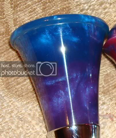

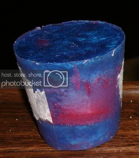

Here's an example of my first PearlEx mix:
Here's another one I did shortly after that, and turned:
I used no dye, just the PearlEx. Now, it's thicker than a pen would be, but it still seems that it would be pretty opaque.
<snip-look above to see the pictures>
<snip again>
