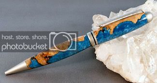

Yes the Pearl-Ex works well with Alumilite.Sometimes I will use an opaque blue or red liquid dye and add Pearl-Ex for for a Pearl effect.The macropearl gets a lot of use in my castings as it adds a nice pearl white effect.I have the 12 pack of 3 gram bottles of pearl-ex and they go a long way.This is an example of Castin Craft opaque blue and Pearl-Ex Macropearl in PR.
