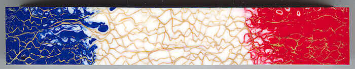

Here is my latest creation. A patriotic "Original Cactus Blank"™! And no, I do not plan to offer these for sale. Tell me what you think!

Curtis - Thats pretty cool.. However, you asked for feedback.
The only thing that I would say is that if I were to make a pen from that, I would want the blank sized for the pen I was making and would think that single blank pens would be best... Zen, sierra, etc. However that would mean sizing the blank with the final pen in mind.
I think it works well. The bright colors and the cactus complement each other. You always seem to come up with something new and creative.
-Barry
You know I love everything you do, but I'm reserving judgment on this one until I see it turned. I'm thinking that powdercoating the barrel red-white-blue may have been the way to go, but you always produce, so I could be wrong.

As to the pen, I think it will turn out nice but would agree that a future blank might turn out a little better if it were made for the size of the pen. However I think it will still look rather nice as a cigar or Toni Twist or such.
Yeah, it would be nice to be able to make it the size of a certain pen but I did not have any control over the proportions of RWB. I basically mixed 3 different cups of Alumilite white. In one I added red dye and in another I added blue dye. With Alumilite white you have 2 minutes or so before it sets! I held and poured all three cups into the mold at one time. Where the resin went from there was up to nature!
That makes sense. I imagine it would be pretty nice but since I know very very little about casting and your stuff looks pretty nice I will believe until someone, or you are, able to prove otherwise.

I love that blank, but you made it backwards! The red should be on the left side! :bulgy-eyes::laugh:
I've never worked with Alumilite, so I don't know it's consistency. With that said, here's an idea that MIGHT work... (YMMV)
Build a "vertical" mold that will hold your cactus blank on end. Only the end on the top would be open. A silicon mold, or other flexible mold, would be best for ease in removing the finished blank. First, put the cactus blank, sized for a snug fit, into the mold. Then pour the blue resin, followed by the white and red. I would think that by virtue or running down the skeleton of the cactus there would be more than enough resistance to keep the colors from mixing a lot, if at all. You could either premeasure the exact quantity for each color and make that amount, or just make a bunch and eyeball it.
Anywho.... my moment of inspiration has passed. Do with it as you will. :bashful:

Assuming that is a 5"+ blank, for a single long pen such as a desktop pen the blank would look nice but for a two part pen such as a Jr Gent for example, where each half is about two inches long, a lot of one color will be cut away. I think the same idea in a 4 1/2" blank would work very well and still leave the same proportions of color.
Did you pour all three colors at once using a third hand for the third color?
...so if he just turned the blank the other way....is that what you mean? :biggrin:
Pretty much... I meant it in the same spirit as an old Three Stooges bit where Curly is trying to pound a nail into a wall head first. Moe informs him that that nail is actually for the opposite wall... :rolleyes::biggrin:
George,
That obstacle is pretty easy to overcome. Simply cut a swath out of the white part in the middle to get each color to be wherever you want it on the respective parts. Cactus is so busy that you really don't have a real "grain" pattern to worry about as long as they generally line up.
And yes, all three colors were poured at the same time by me alone! Pretty tricky, that is why I can't produce them for sale at a price anyone would want to pay!

Tricky.... that's an understatement! I am nervous enough using the clear in four colors in four cups, getting them mixed well then poured and swished just right let alone the time constraint of the white and trying to keep colors seperated.
