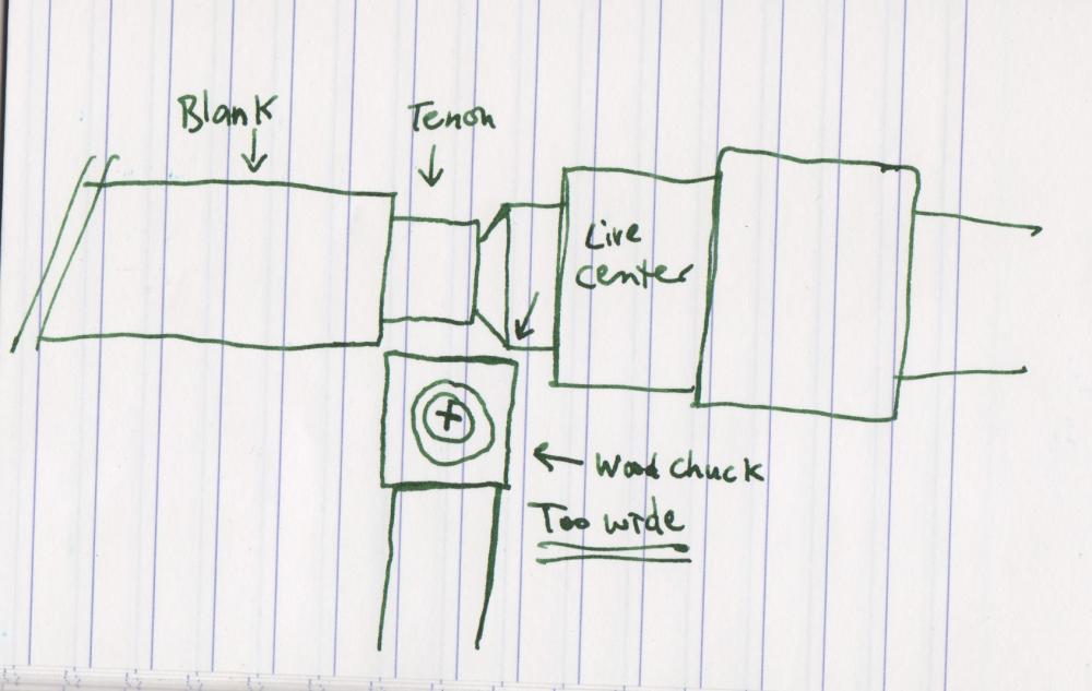

Oh - and it's not so much that I need it for parting, but I use it to make tenons with.
I use the woodchuck and avoid regular turning tools.... it's not so much that I need it for parting, but I use it to make tenons with.
Two thoughts: first, for tenons you probably want a fat turning tool (like the 1/8" one someone linked to. Using a butter knife or sawzall blade makes for a very narrow parting tool, which lets you make parting cuts without losing a lot of material, but won't be nearly as good for cutting a tenon.
Second, have you tried using square inserts for the woodchuck? I mostly use the radius inserts, but the square one has a nice flat edge that should give you a perfect tenon.
What's your sharpening setup? Members here may be able to give you some tips to help you get better (or at least more consistent) results from sharpening.
Currently I don't have any sharpening setup. I need a jig. But I also need a finer grit wheel for my bench grinder - which I bought just so I could sharpen stuff. Ugh...
I have used and do like the square tips for my woodchuck - but the space a tenon needs to be doesn't allow the tip to fit...
For now instead of making the tenon 10 mm wide and using my old parting tool, I'm making the tenon about 18mm wide and then cutting off the end shorter before threading.
