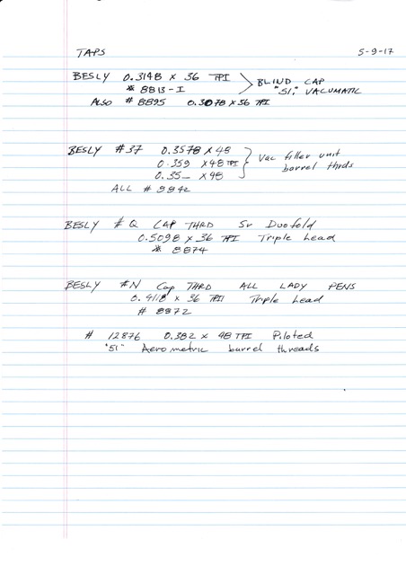

I recently inquired about this as well. Tim from Parker "51" really helped me out. He sent me the following but I haven't gotten around to sourcing the taps from Beasly:
