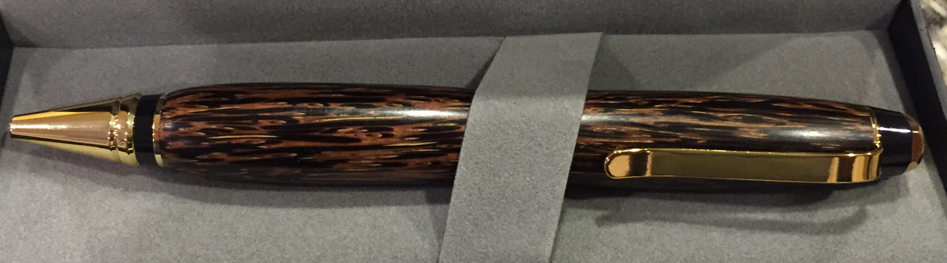

Cigar Pen, Palmwood, CA & friction finish, Gold Hardware, my 6th pen I have made.
The shape was intentional, the owner was a quarterback.

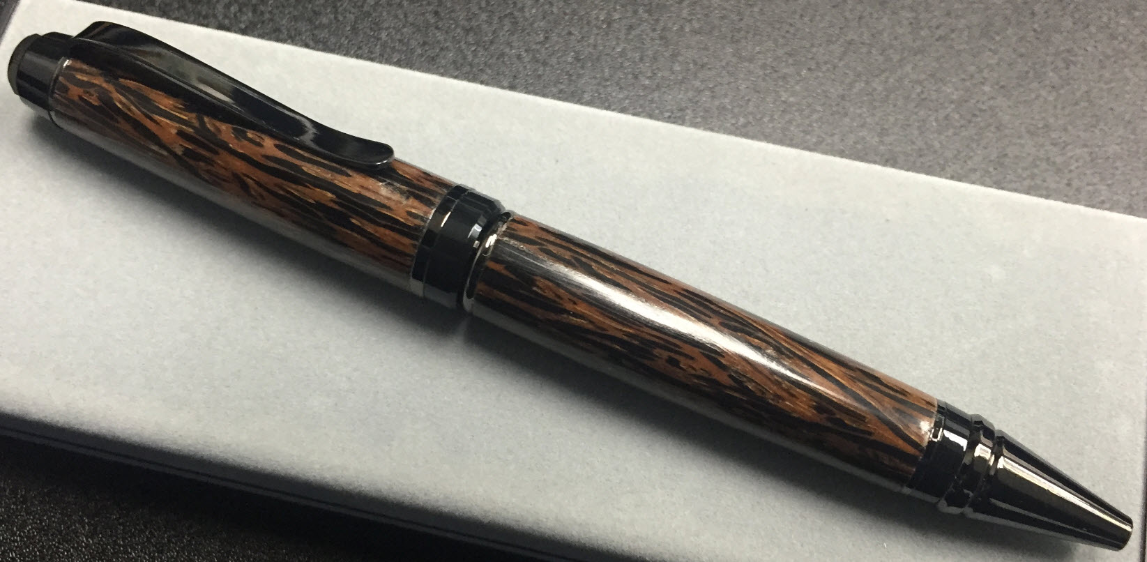

Cigar Pen, Palmwood, CA & friction finish, Gunmetal Hardware, my 22nd pen I have made.
The thin shape was requested by the owner, he wanted the smallest largest pen shape, the owner is french and is accustomed to a S.T. Dupont.
