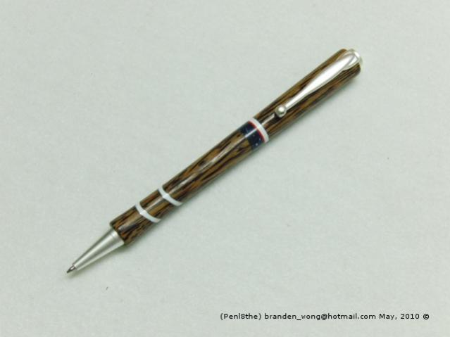

The blank on this slimline is dark palm. So I am not sure if it is the same as any palm tree. It is splintery, but I did not find turning it any differently than other wood.

That pen looks great Branden. the segments make the palm become something and I really like the shape you gave it...heck, that is an inspirational slimline! The food spots or lines or grain differences whatever..they are definitely longer and bigger on the black palm..that's why it is called black palm. Still not that exciting to me, but dressing it up like that certainly starts to change my opinion.
There are many different palms and most of them are no good because the fibers are to soft, some are hard all the way through the tree and some are hard only around the edge of the log, if you cut the palm tree down and you can stick your pocket knife in the end real easy then it will be no good to use, if there is a hard edge and there is enough to use for pen blanks then it will be worth getting, it will look real nice like the picture Branden posted (Great Job Branden). I hope this helps, aloha.
