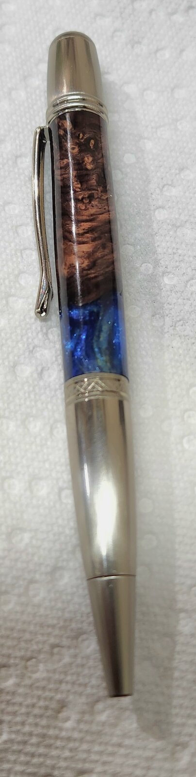

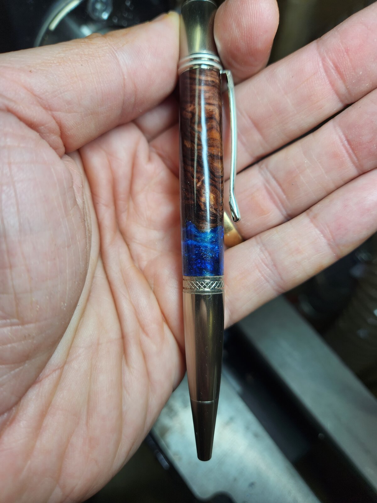

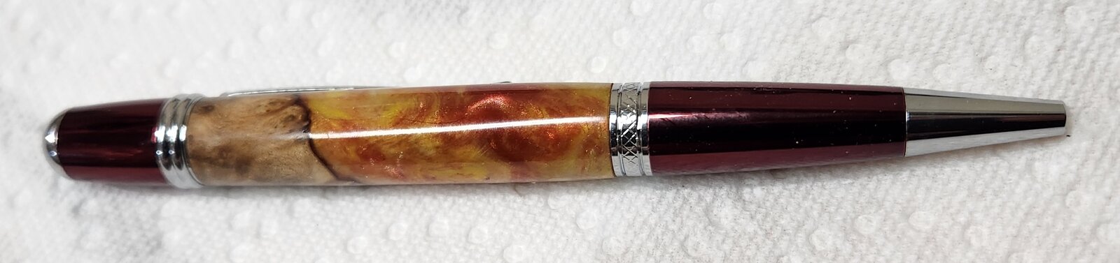

Both are blanks from Facebook group postings. One is a HRB hybrid and damned if I can remember what the other one is.
The stainless kit is one I went to Rizheng directly for (along with way too many other Sierra kits). Both finished with friction polish.
