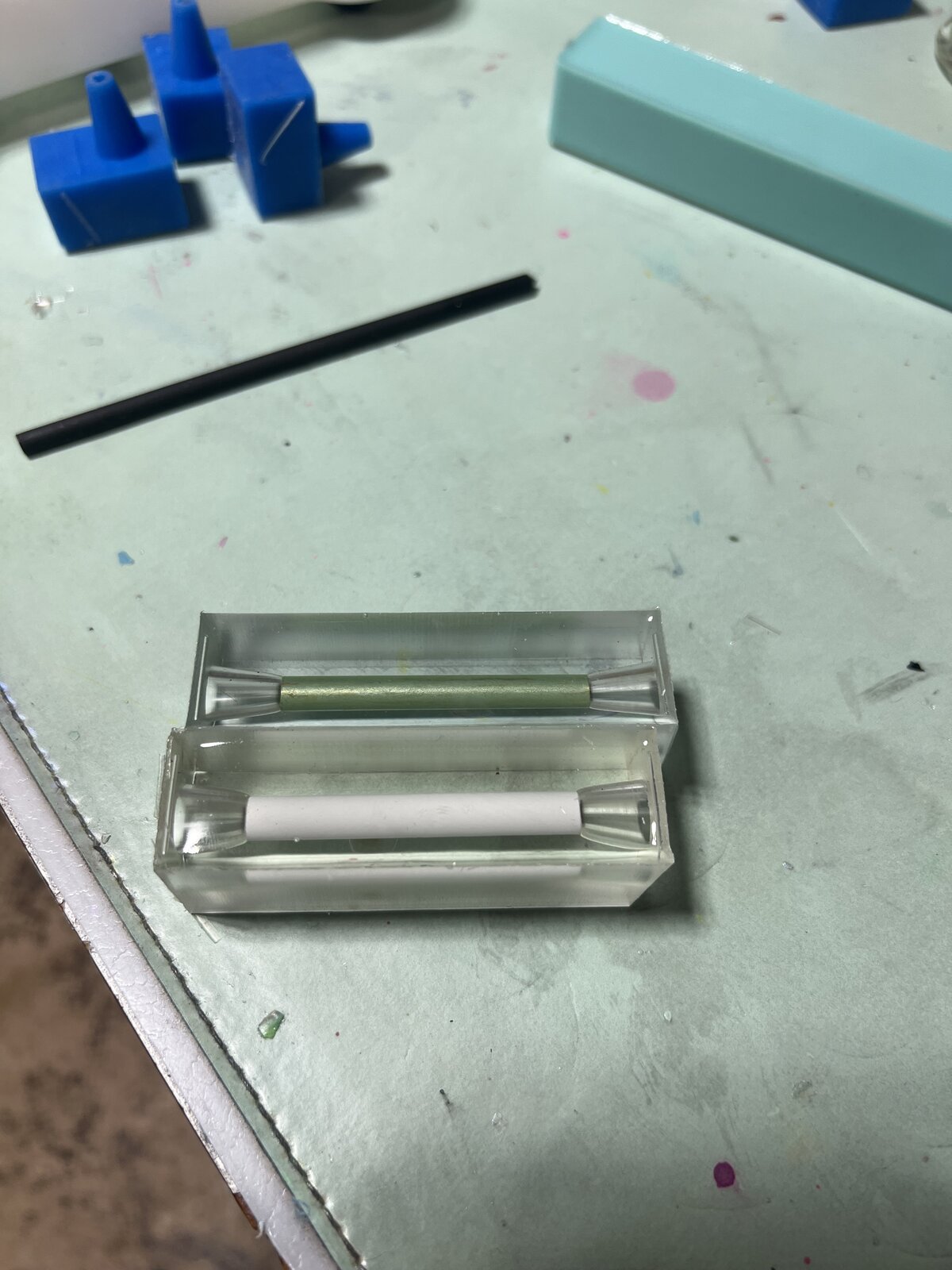

Thanks for the help yesterday guys. Have to say I'm impressed with how my first cast tubes came out. Tried some different paints and resins
I agree with Ken. Unless this was just an experiment, why bother casting plain painted blanks? Inquiring minds would like to know.

What's the end game here? I can't figure out why you'd cast bare tubes.

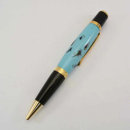

Not my photo, I hope its ok that I'm using BGArtforms photo, if not, I'll remove it, but I'm making several of these blanks for friends. Plus lots of other ideas with painted tubes as well.
Yes there are many ways to deal with this part of blank making as well as many materials that can be used. At one time I dabbled in powdercoating tubes and this method is excellent in that it is a tough finish and does not react with any resins when done. there are many colors to choose from too. The down side is it is messy and also time consuming if doing one or two tubes at a time.
Then there is wrapping the tube with sleeve material such as carbon fibers or other materials such as vinyls. I have gone this route these days because again many colors to choose from and easy to do individual tubes. With sleeve material you do not have seams but with flat wraps you have the seam that can be annoying to some people. This has a negative reaction to some and others like myself do not mind. At times I try hiding it the best I could.
Then there is painting such as you did. Negative about this is not all paints react the same with all resins so need to be aware of this. But again many colors to choose from.
Good luck in your trip down this path in blank making. I am sure at some time you will try different things.
