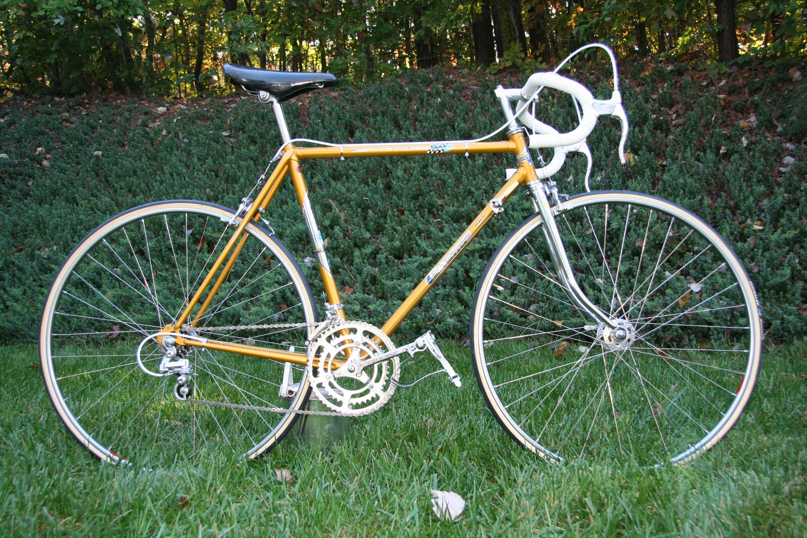

I have restored a 1969 Gitane. I am the original owner. Powdercoat would require a big oven. It would also be difficult if you wanted a specific color match. I used a Sata minijet spray gun. I got results that did not even require buffing afterwards. The paint I used was automotive base coat and clearcoat.
