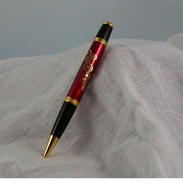

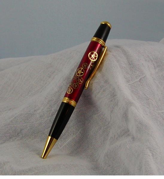

This is how mine turned out, I'm using the resin from woodturners if that has any bearing. I also painted clear polish over the gears after I CA'd them in place
That looks fantastic!
