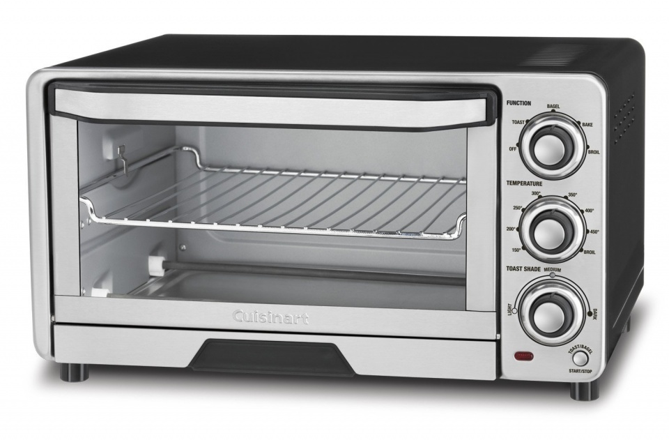

The actually required time for Cactus Juice is 90 minutes which is the timer capacity of most of these smaller ovens. You don't need the convection feature what you need is an oven with heating elements above and below and a good dripping tray something like 71cblhzSn8L._SL1500_.jpg
