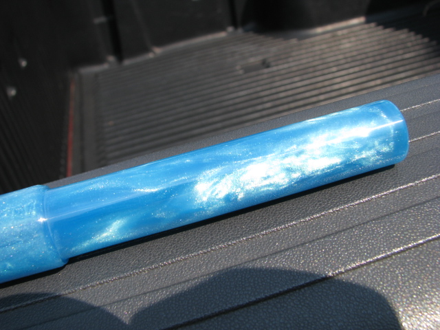

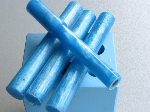

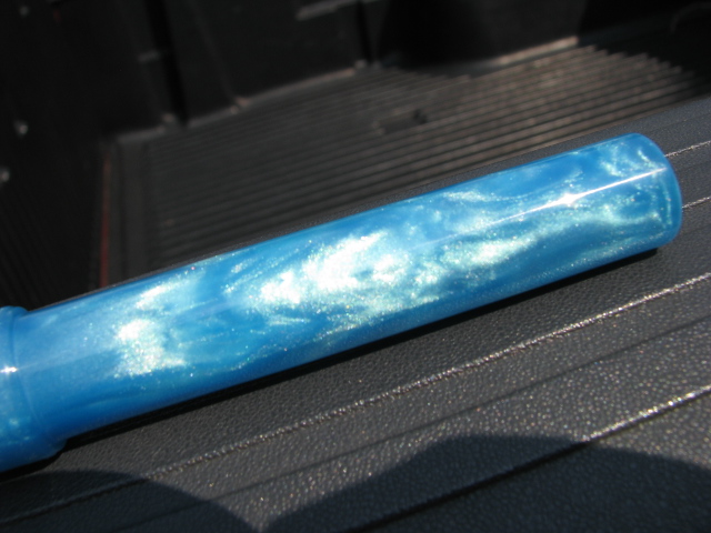

My son-in-law (scoweyjoh) and I attended the recent GA Chapter meeting to watch Jonathon Brooks do his PR casting magic. It took a few weeks to assemble all the materials and equipment required, but we took a shot at it today. The photos below are of our second attempt. The first became a bottle stopper blank when the blue set up too fast to pour into the mold. I poured almost immediately after catalyzing on the second attempt and had better success. We weren't trying to get too fancy, just a two color pour with a 2 to 1 ratio of Pearl Ex Duo Blue-Green and Macropearl. I couldn't wait to turn one round and polish it to see the results.

The vertical mold doesn't allow you to swirl like you would do with the horizontal tray style, so you need something to dip into the mold and twirl as you draw it back up. I watched Jonathon closely and he uses a heavy wire device (I call it his magic wand) that has a hook at the end and a couple of bends along the length. He dipped it in just a few times and swirled it slowly as he brought it back out. I fashioned mine in a similar manner using stainless welding wire and emulated his manner of using it. I think I did well with the swirl, but the pigments I used aren't contrasting enough to really show it in a photo.

Bob, I think they look great. They're much better than my second attempt :redface: I was able to make a pen out of my third attempt but it's still not what I want.

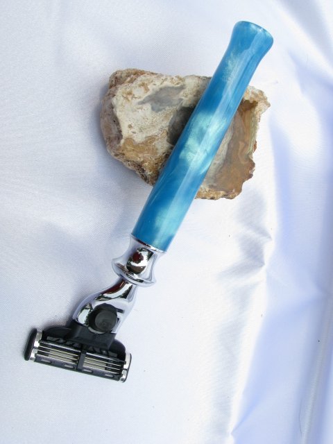

Funny you should mention the Blue Willow. My wife asked tonight if we could go there sometime soon. She also gave me orders that the first blank will become a handle for her new razor. Guess where I'm eating next weekend, and who's getting a new razor.
