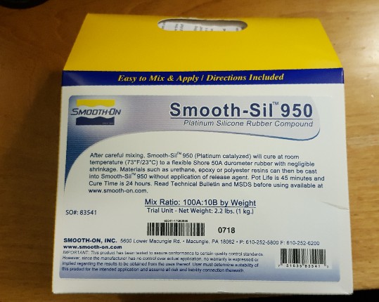

I tried the tin-cure and had some deformation in my pieces after a couple of batches. My local Smooth-On supplier suggested moving to a harder platinum-cure resin and this was the stuff the recommended:
