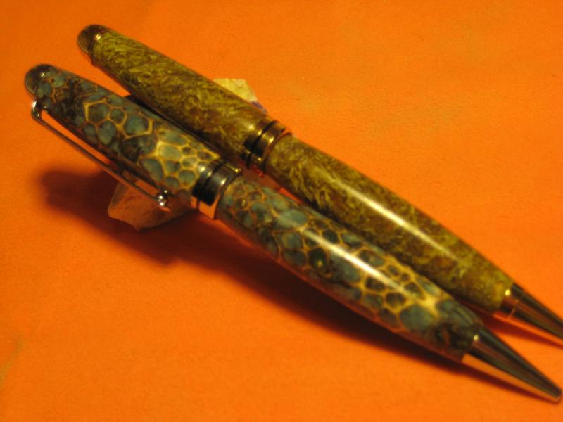

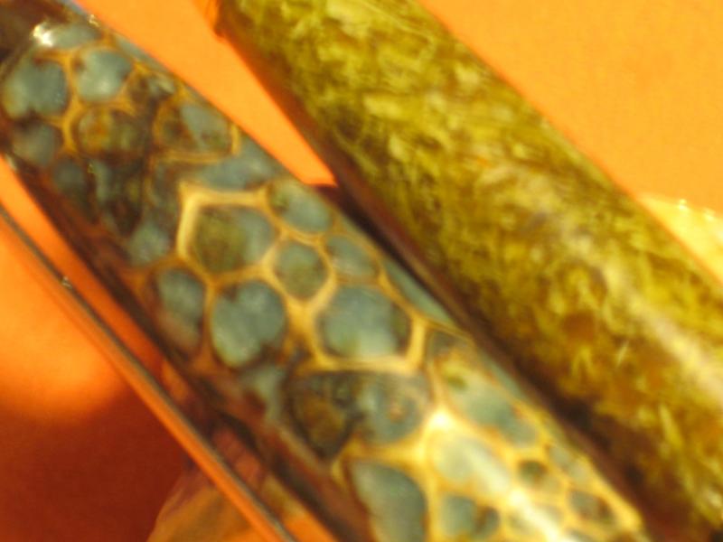

Spent most of my shop time on flatwork but did manage to turn 2 pens.
The one closest to the camera is a gum ball pen (seed pod of the Sweetgum tree) cast in blue pearl PR. The balls were packed into the mold extra close so there were no gaps in the pattern........worked!!
Second one is a casting of Tumbleweed Lichen. This is Masonhalea richardsonii, a long filament lichen that grows from the Rockies into Alaska and the Arctic. It grows in shallow rock depressions with little or no soil. The wind moves it around as it never gets anchored thus the name Tumbleweed.

Interesting blanks, I like them! I especially like the design of the gumball blank, very cool looking!
Thanks for sharing!
Dave
Those gumball pens always remind me of some prehistoric creature :smile:
The lichen made me think of Spanish Moss, which is pretty common here in Florida. I wonder what that would look like cast.
You're going to become to Sweetgum blanks what Curtis is to cactus blanks. I think these are by far the best ones yet! Are you pressure casting them?
Don't have a pressure tank yet so castings are just poured and must settle to wherever. There are a lot of voids to fill turning the gum balls. I just fill them with shavings and thin CA, The blanks take a lot of extra time to turn. Gotta get a pressure tank. Everyone seems to like the pattern so I will turn more of them in other colors. I think a burgundy would look classy. So far none of these blanks have exploded past the point of repair. Extra scary sharp tools and light cuts really help. Cutting the slot for the center ring is a tough trick and uses some extra CA.
