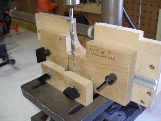

1: I need to redo my homemade centering jig on my DP for drilling the blanks, it has too much flex in it...
2: A complete redesign of the jig on the band saw is needed too.. It just plain bites.

Sounds like fun. We all had to start out somewhere. I have been through a couple of designs on the drill press and the table saw jigs.
I use the one below for drilling, and one similar to this for cutting. I am moving into drilling on the lathe though. Will be much more accurate.
Just a thought.
