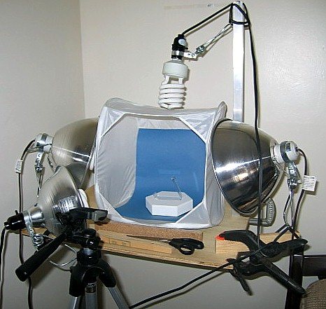

Okee dokee... see what ya think...
Marc Phillips
Jun 1, 2004
900
Columbus, GA, USA.
My pics have been OK.... but lots of glare and I see some really great pics here and it seems like a photo tent is the key...
So....
I bought one on Ebay, $10 shipped, and have been playing with it all morning...
I am using 4 lights... 3 shining through the tent, and 1 shining through the opening directly on the pen...
Please, all comments welcome...
Looking good from over here Marc, the wood looks fantastic in the pic without the glare of the bulbs on the CA finish as before. It is very hard to capture a CA finish with a light tent as the tents` main purpose is to soften the harsh lighting.[8D]
Fantastic pen and picture Marc, you are on the right road!:)
Almost perfect. You need to work on getting rid of the background reflection. You can see parts of the opening of the light tent in the reflection of the hardware.
I wouldn't even know where to begin! :D
Never thought of that... but I sure see it now.
How would I go about getting rid of that? ... really, no clue how that would be done.
You can reduce the reflection by closing off the opening to the tent with something like white posterboard with only a hole cut in it for the lens to stick through. Some of these light tents also have a piece that covers the opening and has a slit in it to do the same thing. Depending on how far from the pen the end of the lens needs to be it may or may not work.
Thanks... I will play around with it a little and see if I can somehow get the camera close enough to shoot through a small opening... right now the camera is about 2 feet from the pen....
But what is the camera? And, if it's a DSLR, what is the lens? My camera is also about that distance from the pen, but that's because of the lens I use.
OOps... forgot...
It's a Canon Powershot S60
I don't know what half this stuff means, but here ya go...

The EXIF information is missing from the photo so I'm missing some information that would have been useful. But, you should be able to move the camera closer and use a wider angle of view. If you look at the photo on page 5 of the article I wrote you'll see a photo of my setup with the camera in place and the also the large sheet of posterboard I use to reduce reflections. You will need to cut two holes in it, one for the lens and also one for the light you have pointing into the tent. It can be done but you will need to fiddle around with it. I recommend starting with a hole for the light maybe only about 2" in diameter.
