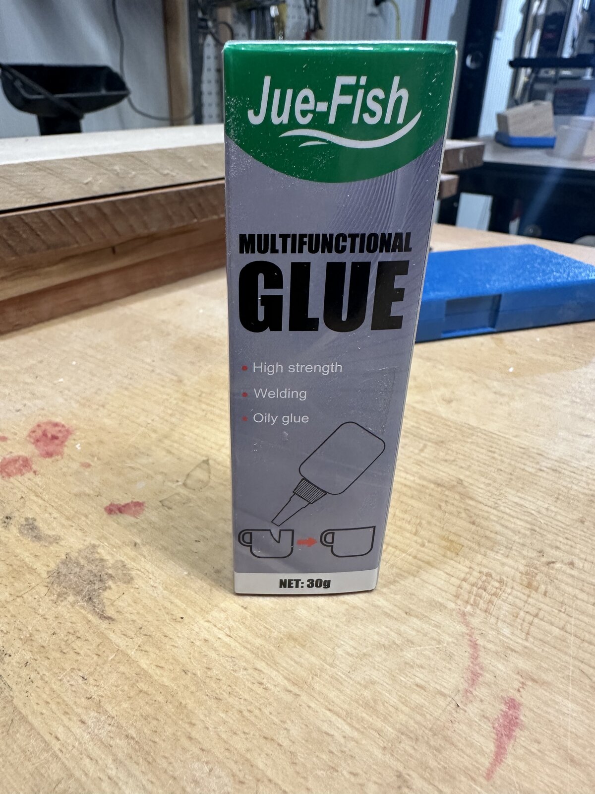

Although I have only used it a few times, haven't been making many pens, it seems to be very resistant to heat. Here's a picture of the brand I bought.

You may have not tried this but will ask anyway. Have you tried using as a finish? Did you try to heat in toaster oven afterwards to see if it hardens any? thanks.
