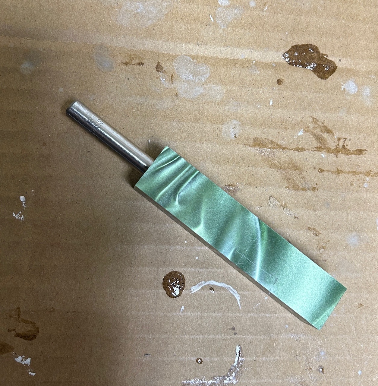

Some things do not change.... Where's the dumpster bucket. However I'm saving this one. Will hit the bit with a micro torch ...heat it just enough to pull it out. The hole has be enlarged after extraction....Being the idiot I am the torch cost more than saving the blank is worth... but I need it anyway. Maybe I'll start to take more time drilling.... (have been saying that for over 10 years)

Any chance you can put the blank in a vice, and use some rubber grip pliers to twist the bit in reverse to extract it without damaging either?
Depending on material, yes. I'm guessing the problem here is that the blank heated enough to expand a bit until the initial bind, then cooled and shrunk to grip the metal like a tax collector on their money.
NOT heat...that is most likely the cause of the problem. Put the whole thing in the freezer. The metal will probably contract more than the resin. No guarantee; but it has worked for me.
I would agree that cooling is probably going to be more effective than heating. Once tooled, back twisting it out should do the trick.

Wouldn't the torque of your drill press be enough to break it free?
No... The lathe shuts down.
It must have melted and gotten in the grooves?
The pieces are united forever. I hate drilling a long acrylic blank... all goes well until the last 20%...and I know I should be more cautious when getting to the end. Some people never learn 😜... doubt if I'm going to try to save it. Mist likely will add to the Hall Of Shame bin.
