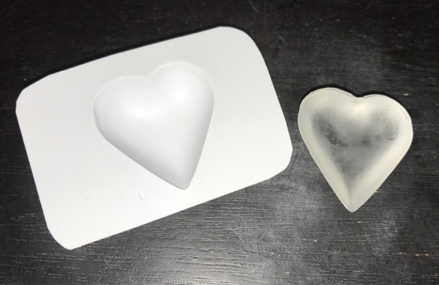

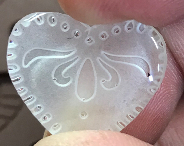

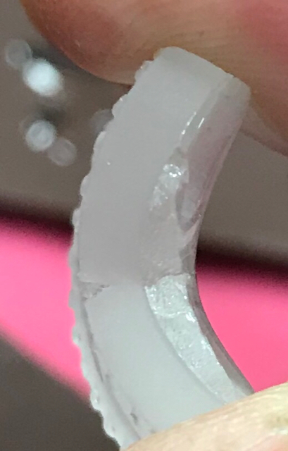

The transparency is great, I would say the same as Alumilite. There are fine details in this mold and an air pocket which neverrose to the surface was trapped in most of the small dots in the mold, as you can see. You are actually looking through the surface of the heart onto a frosted background with the detail.
We will leave the blanks and pieces alone for another 24 hours and see how they are. After the 24 hours under pressure they were still quite pliable out of the mold.
You can easily leave an imprint with a thumbnail in them, however, at this state the "dent" is self healing to the point that after a few minutes you cannot tell where the mark was. As the day went one the effort required to dent it with my nail increased and it healed more quickly.
You can see the small tear forming. Hour by hour the tear became more prevalent with the increased force to bend the heart. This would be expected as the resin continues to cure. The tear is not self healing.

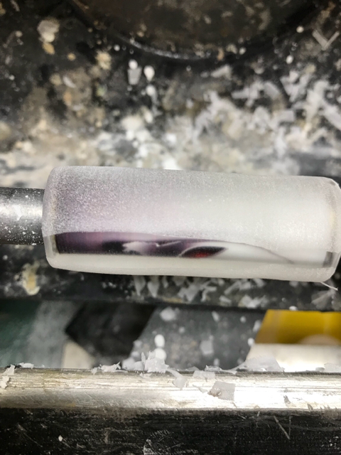

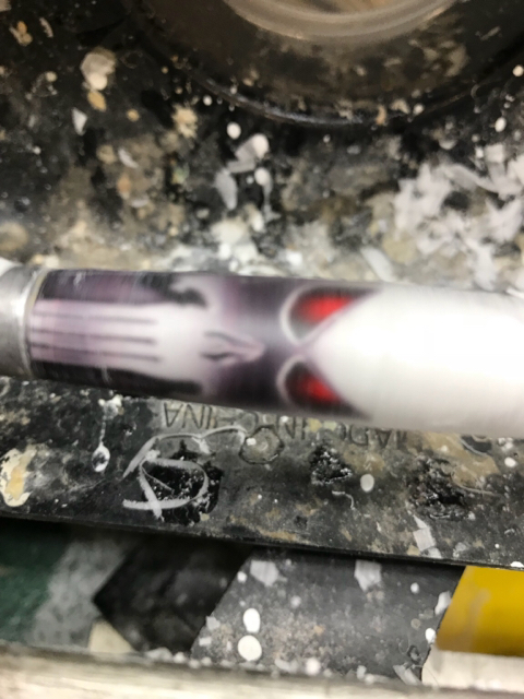

Yesterday, Chuck reported that he tried turning one and it wasn't ready, soft and gummy halfway to the tube.

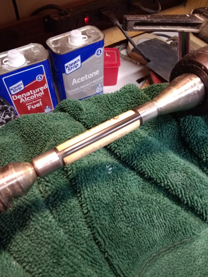

I tried turning one the morning. And it did pretty well at first.
Here is the surface as I rounded with a gouge:
Here with carbide (Magic Skew):
And finally with a skew:
As I got close to the tube it became a little softer and a tad gummy on one end. This affected my ability to polish it up, though overall it was going pretty well.
At this point I am concerned we may not have had the mix quite perfect. Based on feedback above from Ernie and Francisco. If so Liquid Diamonds is pretty unforgiving.

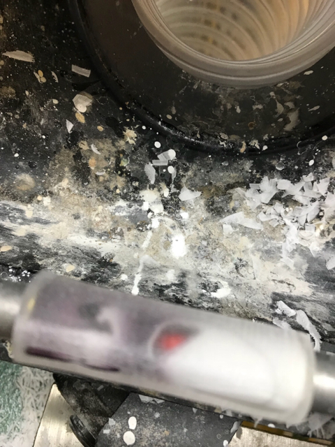

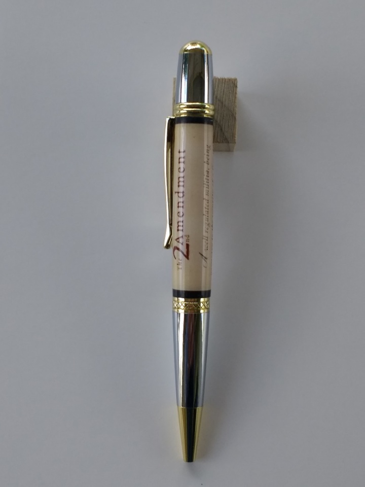

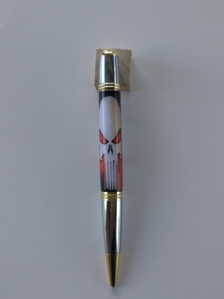

Sorry. Had a busy day today. So I turned this one blank, and polished it. It appears JohnU was correct in his experience. The LD just didn't polish to a usual shine. Which tells me it was still too soft. So, it has now been 5 days since we poured the blanks.
I'll try more polishing on this one, and turn another blank as well tomorrow.

I would expect it to be cured by now, but may take a week. Chuck, did you notice the difference in smell while turning? I think it smells way different than pr or alumilite
I didn't get time to work with the blank yesterday. But I did give the others on my desk the thumbnail test. Still able to make a dent in the surface. I'm not very impressed right now.

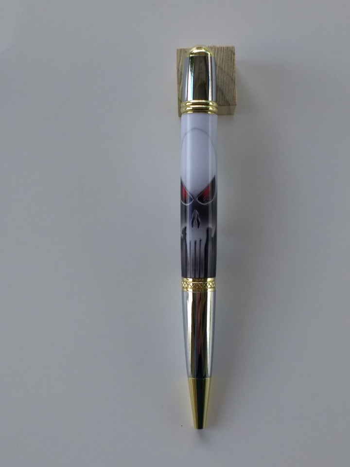

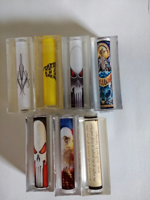

Here are a few of the blanks we cast on the 1st of Sept. I think the Liquid Diamonds looks pretty nice. These are some Labels I printed, using waterproof paper from Online Labels.
