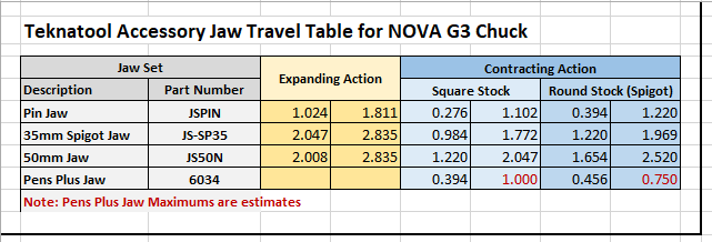

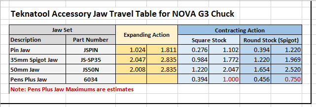

I haven't confirmed these with actual use, but from the chart I have inside my Nova G3 chuck storage box,
So, it looks like the 35mm Spigot Jaw would be able to fit 1.5" round stock as well as 1.5" square stock.

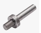

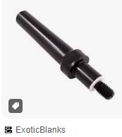

For turning I use one of several methods I have. One is a dedicated Bottle Stopper MT2 mandrel and the other is a set of mandrels that are held in either a collet chuck or in a jacobs chuck on the headstock, like these:
View attachment 383324 View attachment 383326

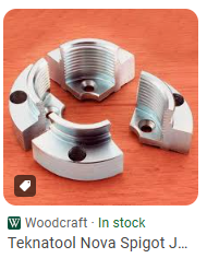

Thank-you Dave for the Fast Reply. Yes I do drill on my Lathe so I need to hold 1.5" cylindrical stopper Blanks. I do have some that look Similar to the 35MM Spigot Jaws. I will look into getting a set of these . What I did to get me by today was cut a 1.5 inch piece of PVC pipe off then cut it into 2 halves, then stretched it to fit around stopper blank and then pinch it in my chuck jaws.
