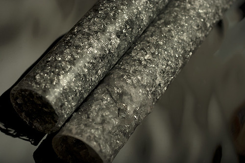

After the oven cure, they finally hardened. Too bad that section isn't usable.
In the pic, the top one is a fresh-from-the-mold "normal" blank and the bottom one shows a blank with the section that didn't cure normally but had to be cured in the oven.
Silver Leaf Blanks - One fail, one win. by DurocShark, on Flickr
The batch will be scrapped.
