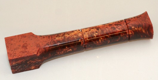

Blank = "RhinoPlastic My Two Cents" Turned:2,500rpm using a Easy Wood Tools CIO carbide tipped tool. Left: Wet Sanded to 800g using Mirka Goldflex then one coat of RhinoPlastic polish, Middle: Mirka to 800g, MicroMesh to 12,000g, RhinoPlastic Polish. Right: Results before sanding (tool only). Conclusion: The "Left Method" acchieves a fast shiny result. Adding Micromesh results in a superior shine but add additional time.

In less than a minute, I was ready to buff. (Remember I did nearly ALL resins--wood is more difficult, I believe).
Buffing may take two minutes (remember to do the ends of the blank, that's the most likely place for scratches, since you did not want to hit your bushings!!)
Hope this helps,
Ed
