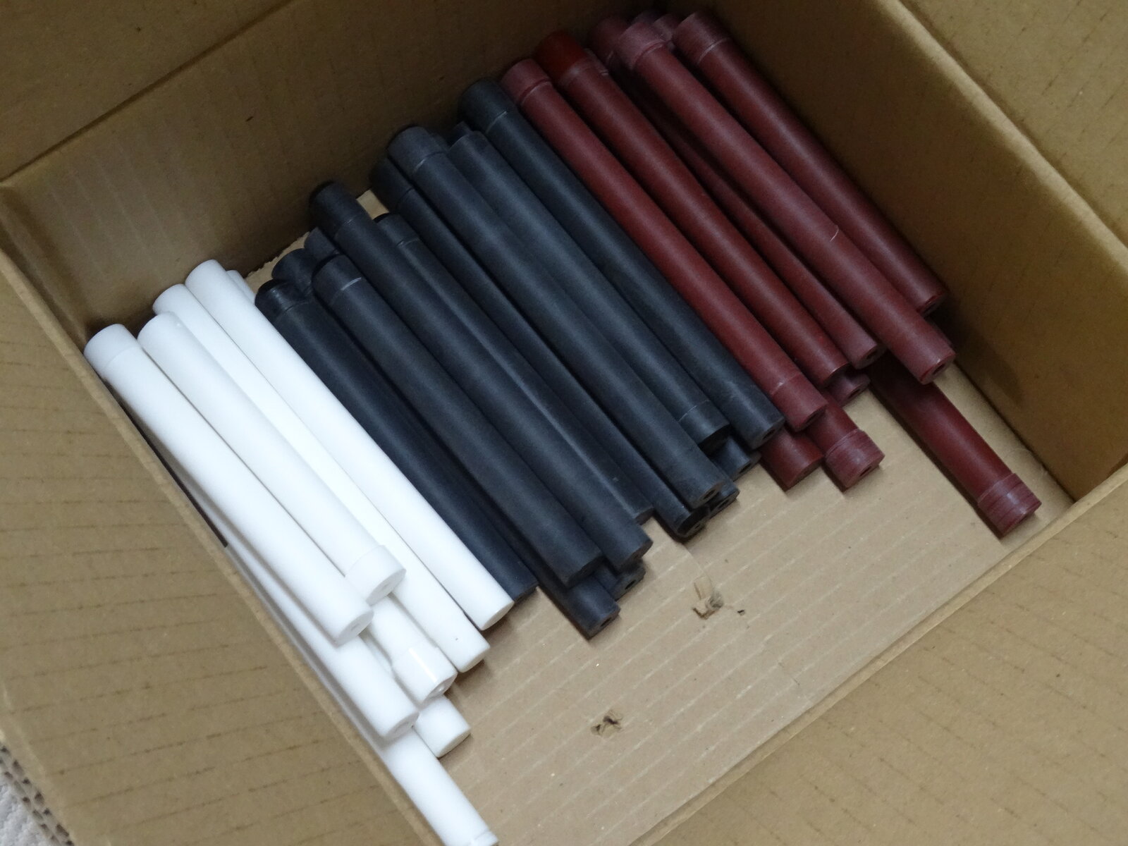

Hello everyone. I produce acrylic rod for my own use by the casting process. I only do it because I don't find this material available in small quantities and at the quality level for pen production on the market. The process is similar to denture production, I use glass test tube to obtain solid cylinders. The material (PMMA) is marvelous for pens, ease to turn and polish. Thermal treatment is mandatory to stabilize final products. Acrylic acetate is a "blend", sometimes produced from recycled material, not the same performance than acrylic casting.
I can say that it really is not such a simple task for a hobby to prepare at home. It is not impossible, but it is laborious and there are many variables to control. Main problem is the bubbles and contractions of the material. The monomer is highly flammable, especially when heated, be very careful. Polymerization must take place in a slow and controlled way inside an autoclave pressurized with CO2 or N2 gas (avoid fires or explosions).
Some rods produced:
And some problems that I mentioned, bubbles ... Sometimes fails occur
