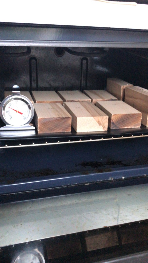

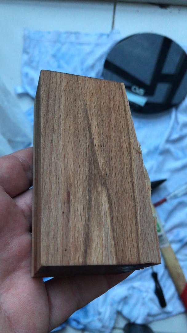

Hi All,
I am new to stabilizing and I am still at the trial/error stage (also new to this forum, this is my first message...:)). I have tried a couple of types of wood with CJ, clear and/or dyed with anilin powder dyes. I have my own DIY vacuum chamber with which I can achieve up to 740 mmHg vacuum. My problem is that I cannot get full penetration. Here is my process on how I am doing it:
- I have tried Teak, Mahogany, Ash, Beech blanks of sizes roughly 40 x 60 x 110 mm. Moisture content is measured and they have a MC of about ~10%.
- Each time, I put them under vacuum up to 740 mmHg (~29"). At the start, I build up the vacuum level step by step with control so I do not have extensive bubbling. Blanks are completely submerged in CJ by weight.
- After I have a steady vacuum approx. after 15-30 min., I seal the chamber and leave the blanks inside overnight. I check the vacuum level from time to time to be sure that the vacuum is stable.
- In the morning, I check the vacuum level if it is still at the same level (usually it is) and also the air bubbles. If the vacuum has not dropped and there are no (or very few) air bubbles, I release the vacuum slowly and keep the blanks twice the time I had them under vacuum and let them soak. If there is a vacuum drop, I activate the vacuum pump again (without releasing the vacuum) to get to the desired vacuum level and continue to keep the blanks under vacuum (I must add that if I do the first part right and have a stable vacuum, the vacuum rarely drops till the morning and stays at the same level all the time, despite all the bubbles).
- I bake the blanks in the oven at the suggested temperature (~90 oC, using an oven thermometer) for 2-3 hours.
- I close the heating and let them cool inside the oven.

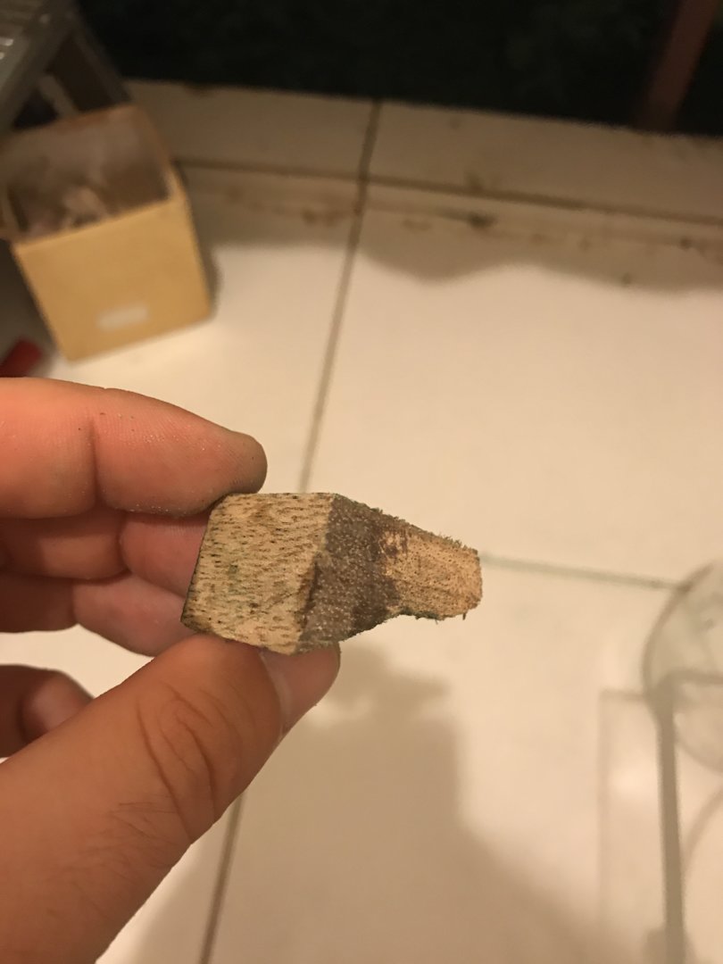

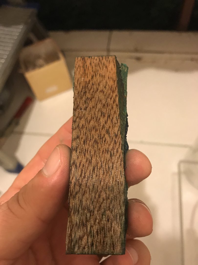

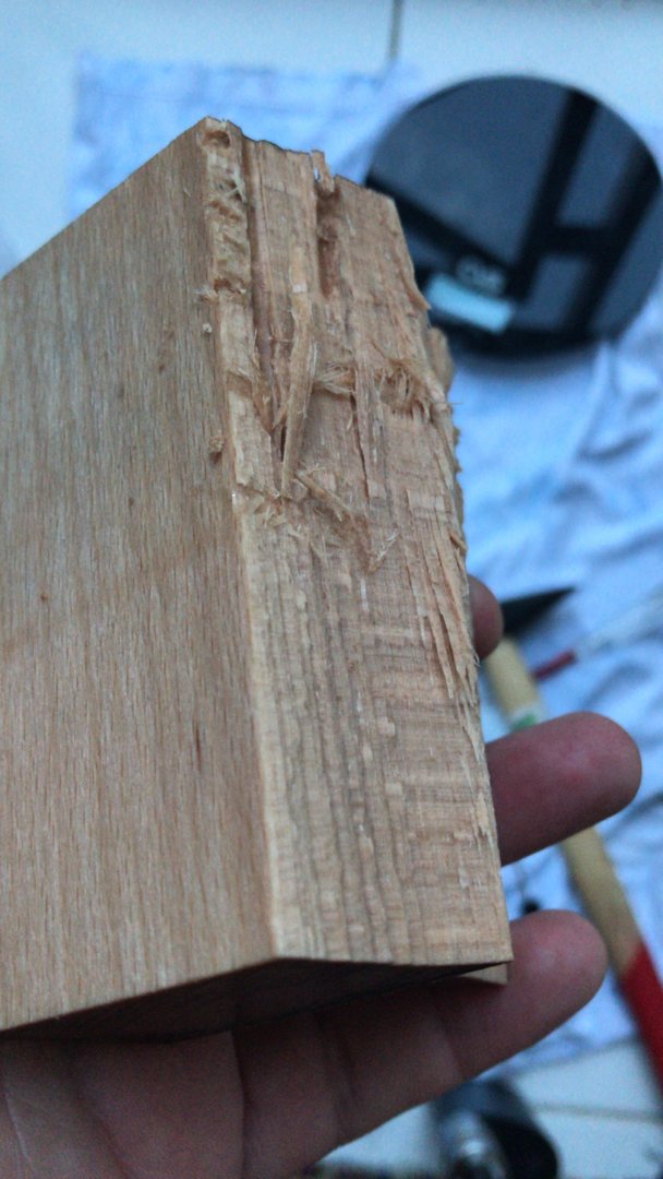

After cooling down of the blanks, when I check the inside of them, I can hardly notice penetration, even with clear CJ. I have also tried with dyed CJ with a small piece of Beech, the surface was looking extremely well but the inside was without any penetration, not even a millimeter.
What am I doing wrong? Any help/suggestion/recommendation will be highly appreciated.
TIA
Addition: I also weigh my blanks before and after the process. As an example, the Teak blank weighed 187/231/225 gr. (before/after soaking/after drying), so there was a CJ intake of about 40 gr.
Even 10% moisture is too much. Bake the blanks before you stabilise them, cool them in the oven, store in a ziplock if not doing them right away. The moisture will boil out and force the CJ back out when curing if not removed.
Thanks for the reply Gary. On the CJ website in the FAQ, I recall that I had read "MC 10% or lower", that's why I didn't hesitate to start the process. I will try with baking the blanks first then. Any other thing that looks wrong?

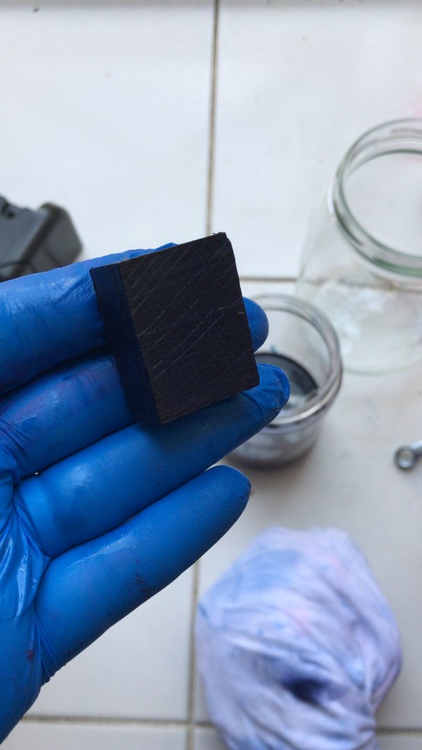

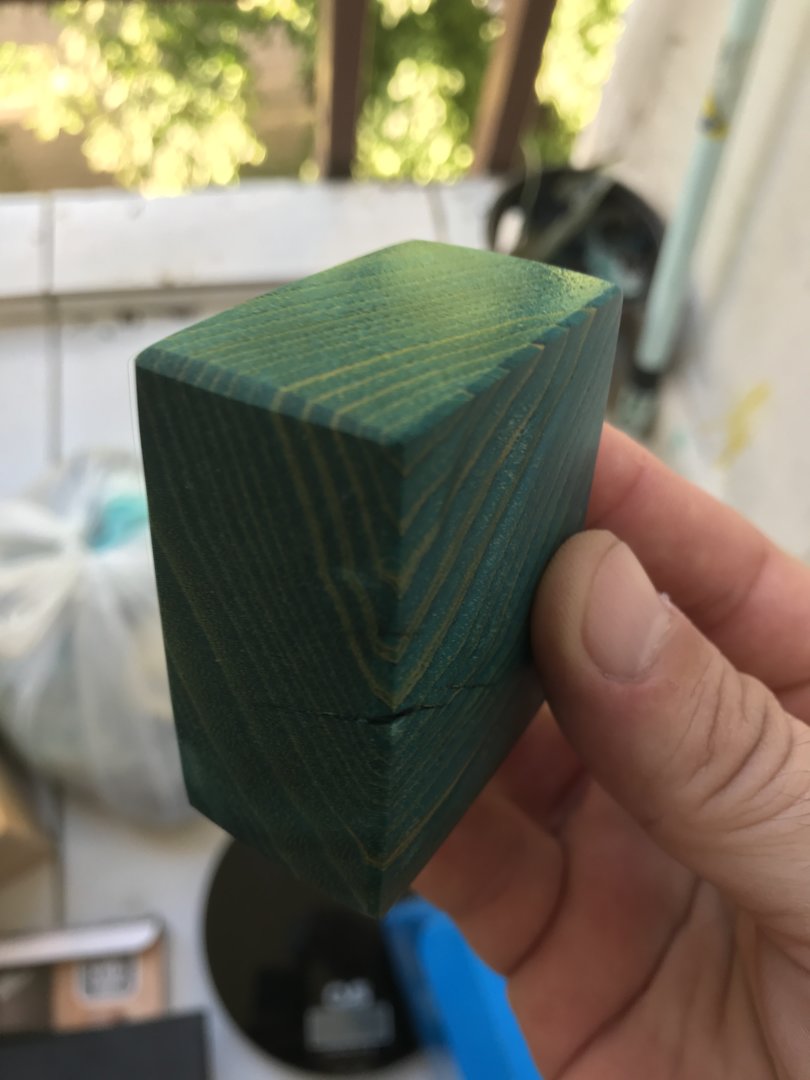

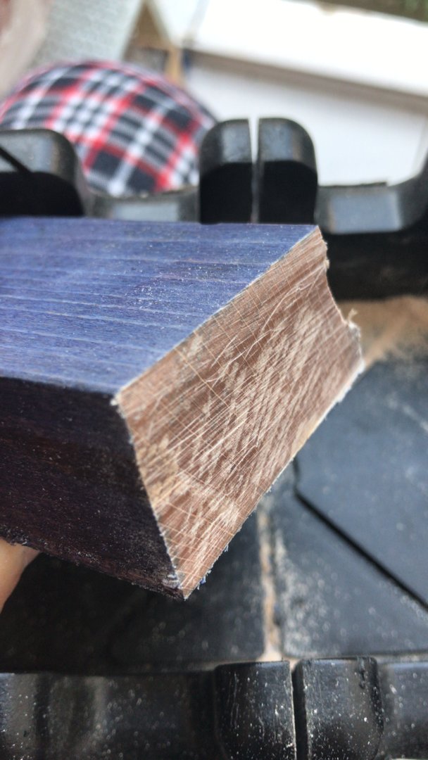

One question about the dyed CJ. Could the MC also be the reason for no penetration? I am attaching the pictures from the sample that I did. If dried properly, would I have full penetration?
Welcome Aboard from Franklin, Indiana!
I have recently been doing a lot of trials with dying. A couple of things I have learned. Different types of dyes have significantly different results in color uptake in wood. The Cactus Juice branded dyes do well as the Alumilite concentrated liquid dyes. I have also done of with the StickFast powdered pigment.
I have also noticed that dye transfer with less than 30% resin uptake can be pretty hit and miss, I expect there are methods of getting good dye transfer into the wood with no resin, also.
I meant to address the dye selection in my first reply--Mike's got it though with his response above. TurnTex recommends only their own dyes or Alumilite dyes. i've used both successfully. Seems like Curtis also notes on his site that powdered dyes are not likely to mix well with the Cactus Juice. So...the density of wood and moisture content are two core problems, then the choice of dye adds to it. My translation would be that CJ carries a few dyes well--but will not likely carry powdered dyes into wood.
earl
Under vacuum water will boil at room temperature, so if there is moisture in the blank then this moisture starts to change to a gas (after a while under vacuum its probably not air bubbles, more likely its water vapor that is bubbling out). As the water vapor is leaving the blank there is no way for CJ to penetrate -- no matter how long you go you are always right where you started. This is why the drying is critical when vacuum stabilizing. Holding the blanks in the vacuum chamber (without the pump running) provides little if any benefit (in my experience as well as tests performed by others). Lastly, be sure to soak the blanks at atmospheric pressure (leave in the vacuum chamber, totally submerged, but not under vacuum). This allows the CJ to creep back into the tiny pores. I soak for atleast 24 hours, sometimes several days if I don't have time to do the curing.
The last thing I will mention is that woods behave rather strange when stabilizing. I've fond that spalted woods tend to soak up the most juice, but it tends to be a crap shoot. My bet is that woods that soak up lots of juice will also dye well, but I've never dyed (or died :p ). Here is a thread where I posted the data that I've collected in my stabilizing journey: https://www.penturners.org/threads/my-stabilizing-data-various-woods.152942/#post-2008481

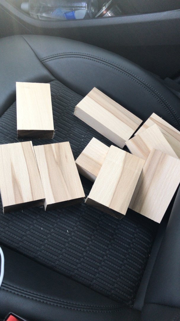

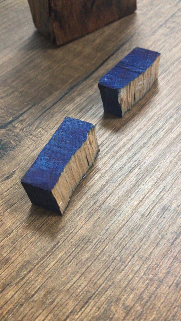

- I found a nice long breech blank and have it cut to smaller pieces. Measured the MC on all of the small pieces on all sides and noted the values. I measured ~10-12% on average. So baked them in my oven till I measured ~0%.

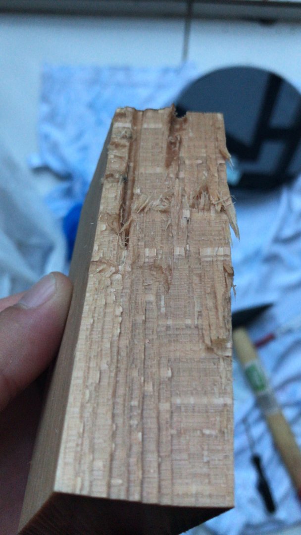

- I did some stabilization tests. With clear CJ, I was able to achieve almost full penetration. Looks like the MC was the problem.

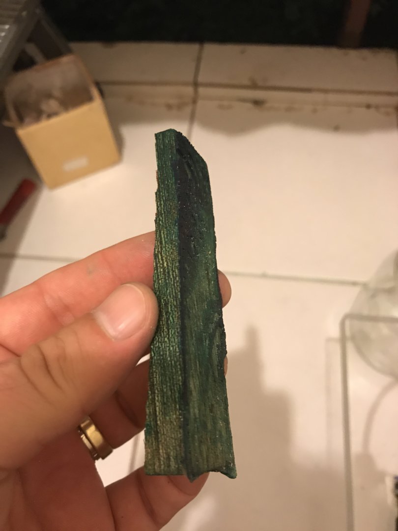

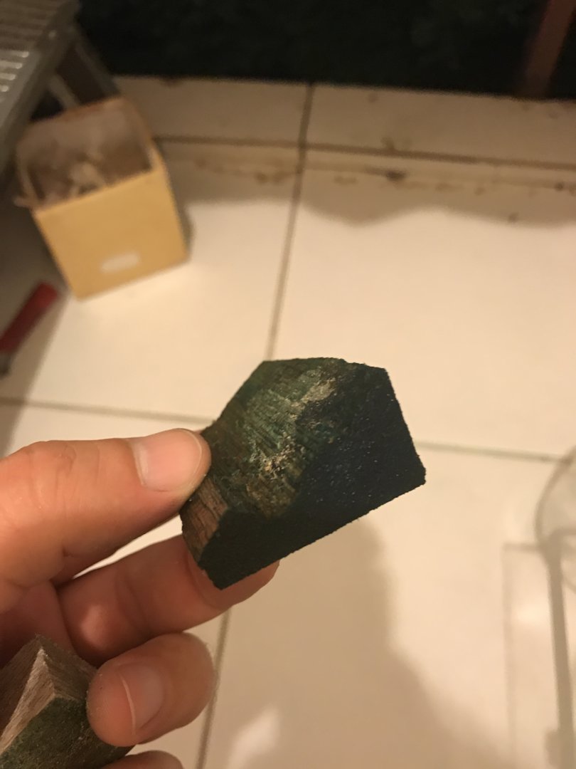

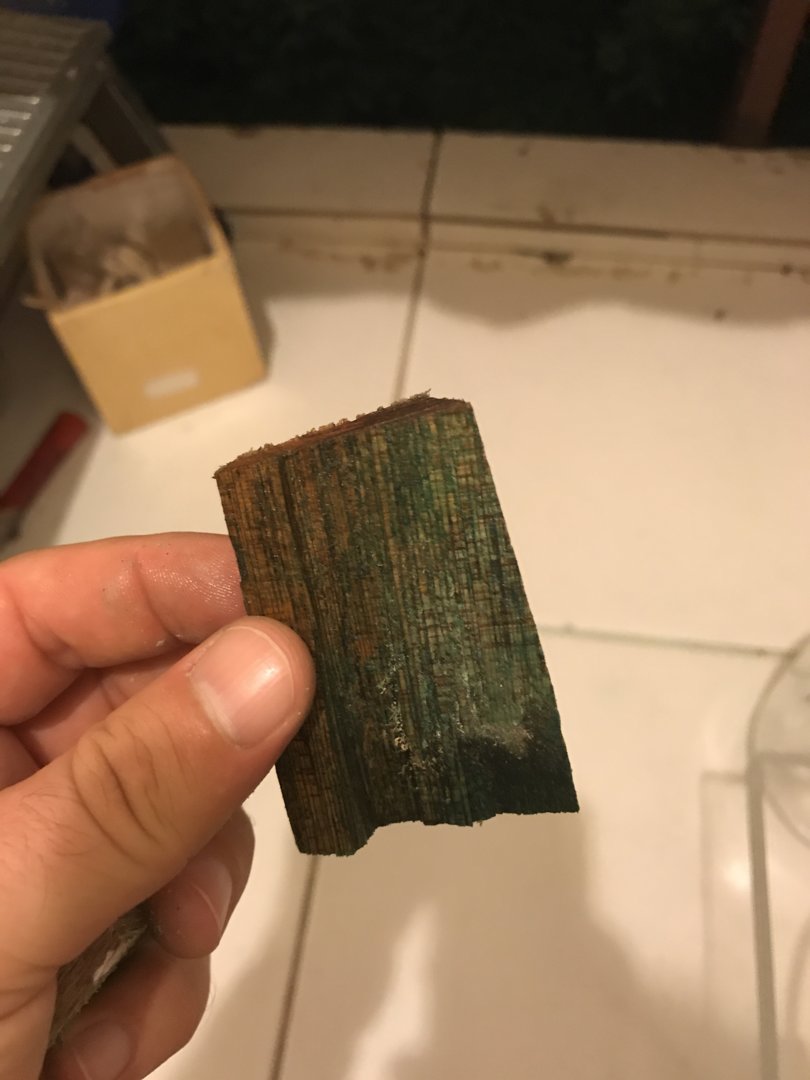

- But when it comes to dying, I still have no success. Tried different concentrations of the powder dye but still nothing.
I keep trying but any suggestion/comment would be appreciated...

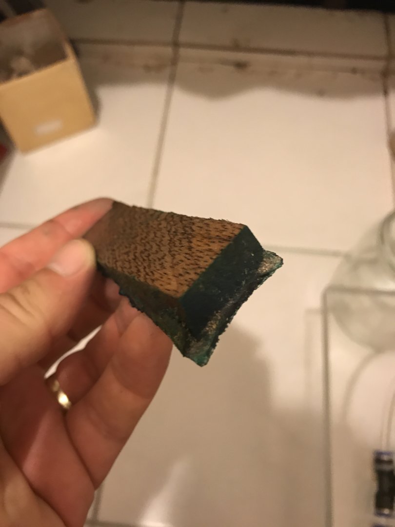

A few updates...

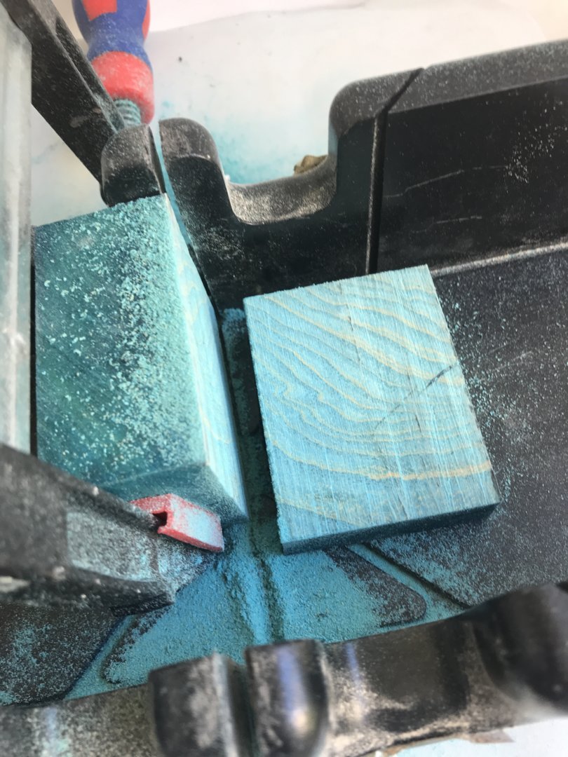

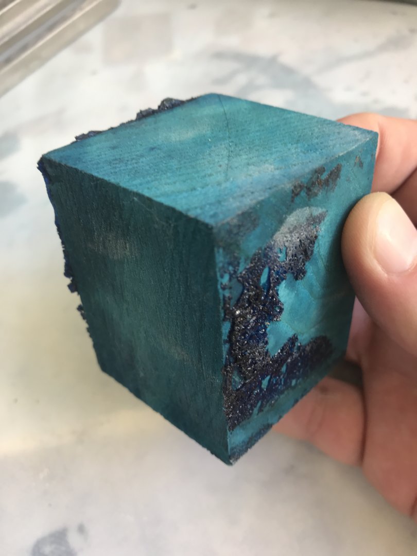

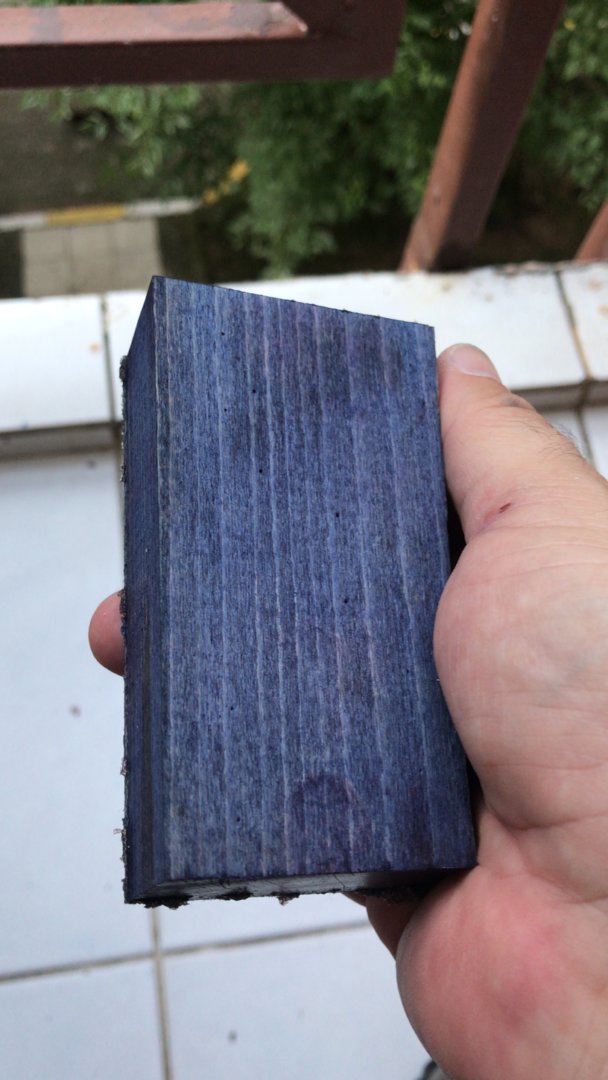

As I still didn't have a chance to put my hands on CJ dyes, I keep trying alternatives. Since the start of this post, thanks to the great help from the replies, I have minimized the variables. Besides the type of wood and dyes, I think I have "stabilized" my process...:)

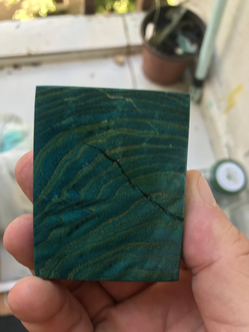

My latest trial was with Mahogany blocks and liquid pigment dyes. Below is the outcome:
Is it the wood or the dye? Still not sure about it. I will have to keep trying.
On the other hand, with undyed stabilizing it looks ok. But one question: How does everyone here determine (or be sure) whether full penetration has been achieved or not? I am very curious about the methods...:)
Well, I can see that you have been making some tests and that is how we all learnt but I think that you are using the wrong woods for dying/colouring successfully/100%, I would suggest that you get your hands on some spalted maple, Buckeye burl or similar soft stuff and try your system and dyes on them, it will give you some answers such as if colour still not penetrate on those type woods, the dyes are either not suitable or you are doing something wrong. I can see that you understood the importance of having the wood dried to 0%MC prior to stabilising that alone is a critical aspect for success, you said you haven't tried the Alumilite dyes which are the dyes recommended for CJ, if your dyes work on either of the 2 types of wood I mentioned that means that I was right about the woods you are using for colouring and your problem is not the dyes type but the woods used, but I still recommend you getting some Alumilite dyes and try.
As for testing full CJ penetration well, with colour/dyes is obvious but with the clear CJ is not as easy particularly if the woods are dense, with soft and medium hardness woods, weighing the blanks before and after stabilising can give you a good indication of liquid weight added to the raw wood, calculation of the blank area and volume added will give you some answers, however, if you cut/cross cut one end of the blank put it upright and grab something you can use to put some water drops on the whole surface of the cut, the middle part would be the area in question so the test is simple, if you see water soaking into the wood, that area has no CJ all areas where the CJ has penetrated and has been cure/cooked water will simply not penetrate.
There are other methods such as when you turn a piece of wood that has been stabilised but you suspect it didn't penetrate much, areas with the cured CJ, the tool (any tool) will cut fine particles while on raw/unstabilised wood you will get shavings.

I think the problem here is the powder dyes are not dissolving into the CJ but remains as a suspension, therefore the wood is filtering the particles out. Find an alcohol soluble dye or a liquid dye and try again. I think the alcohol soluble needs to be dissolved in a bit of alcohol before its mixed with the CJ, not sure if it will dissolve in on its own.

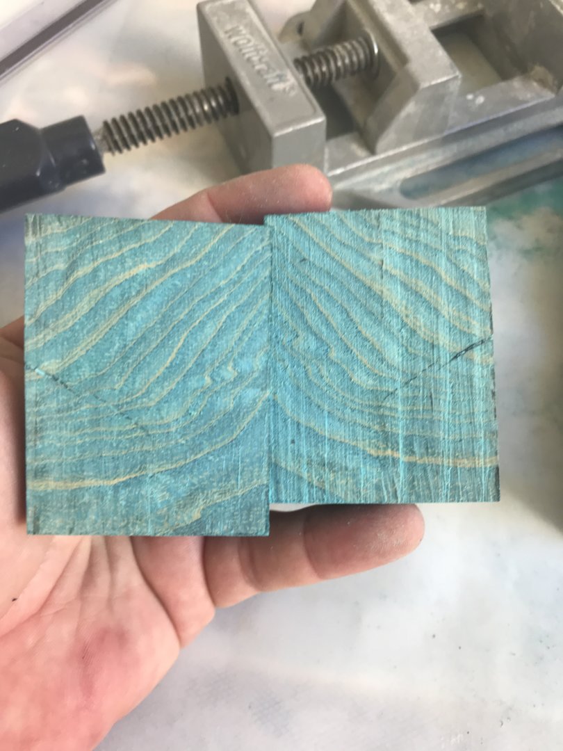

I have found a piece of oak which is in the oven now for the drying process. MC was about 13-14% which I think is normal for the start since all of the wood I have tried until now I measured similar content at the start. I am also waiting for some walnut burl, will try that as well for the dying.
I always weigh the blanks during the process, even during drying since I don't 100% trust the MC measurement device. As an example, the small piece of mahogany in my latest post doubled its weight based on the weight measurement before and after stabilizing. Good tips for finding out about full clear CJ penetration as well, will try those...👍

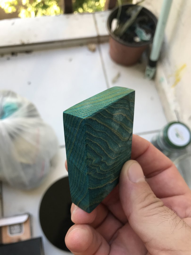

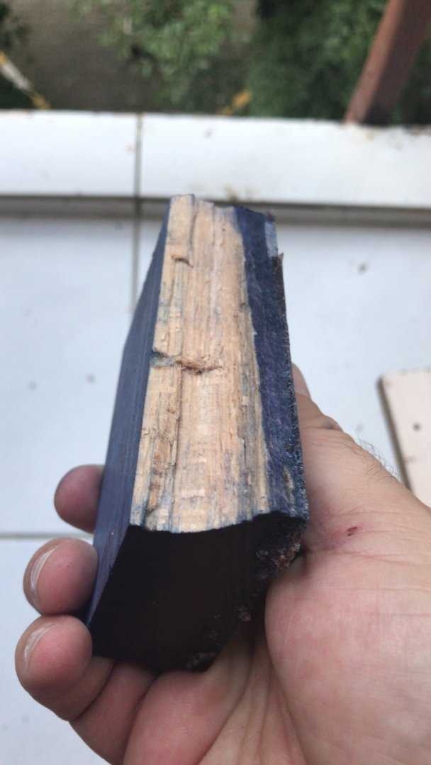

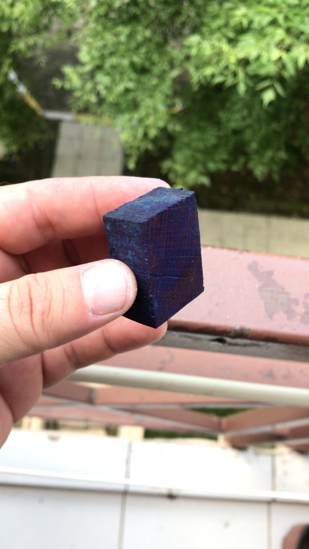

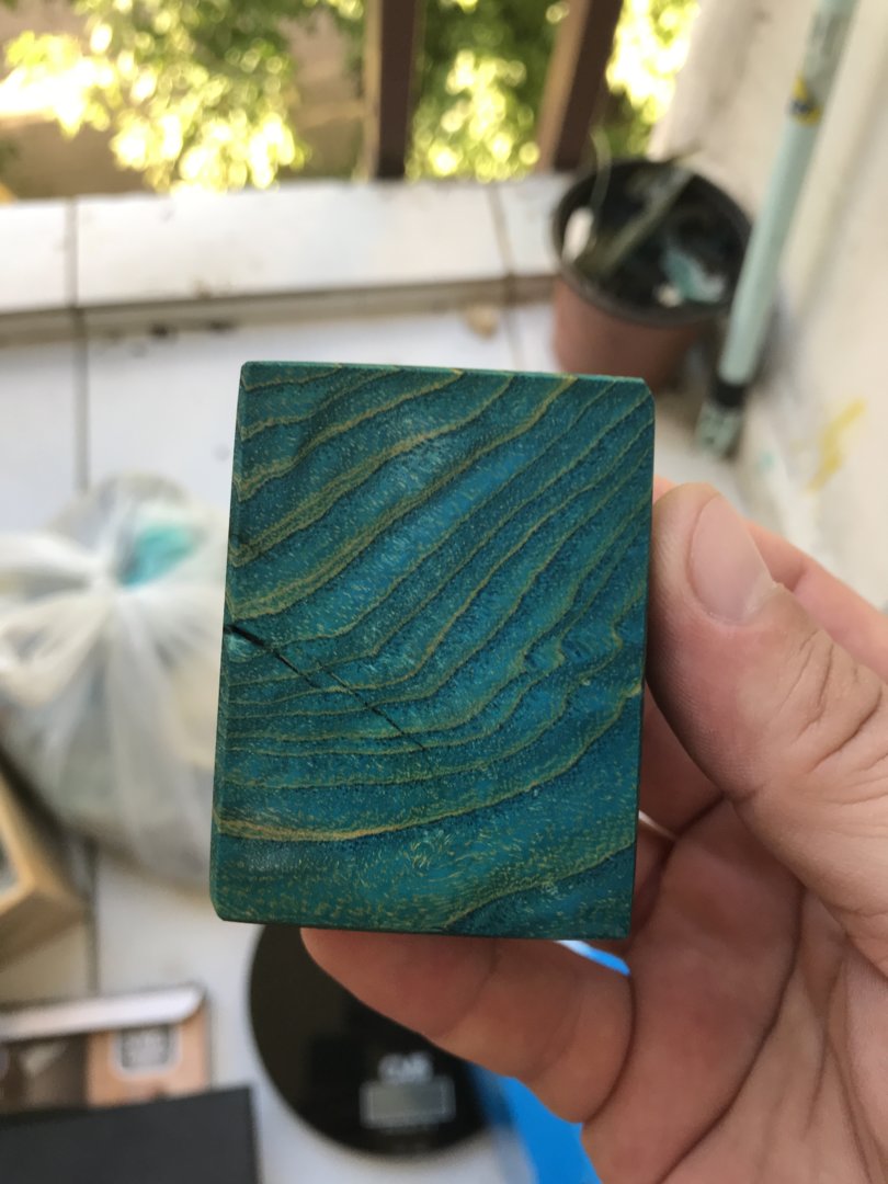

Time to update...:)
After all the tries and errors, finally I was able to lay my hands on CJ dyes. Just finished the process for a sample piece of White Ash. Looks like problem(s) solved...:)
Many thanks for all the posts here aimed to help. Big thanks and appreciation to Curtis for being so patient to answer my questions...;)
Time to find some nice looking wood now...:)
