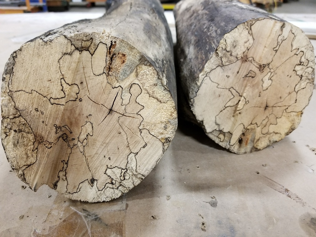

I was on my property last week and found a nice rotting tree.
I will stabilize it and use some for a pen or two and some for a cheese knife handle. I'll post picks when they are done.
Not sure what species it started as, the property is covered with Maple, Ash, Elm, and basswood - so any one of them I suppose. The more solid parts of it look a bit like maple, so I'm leaning maple.

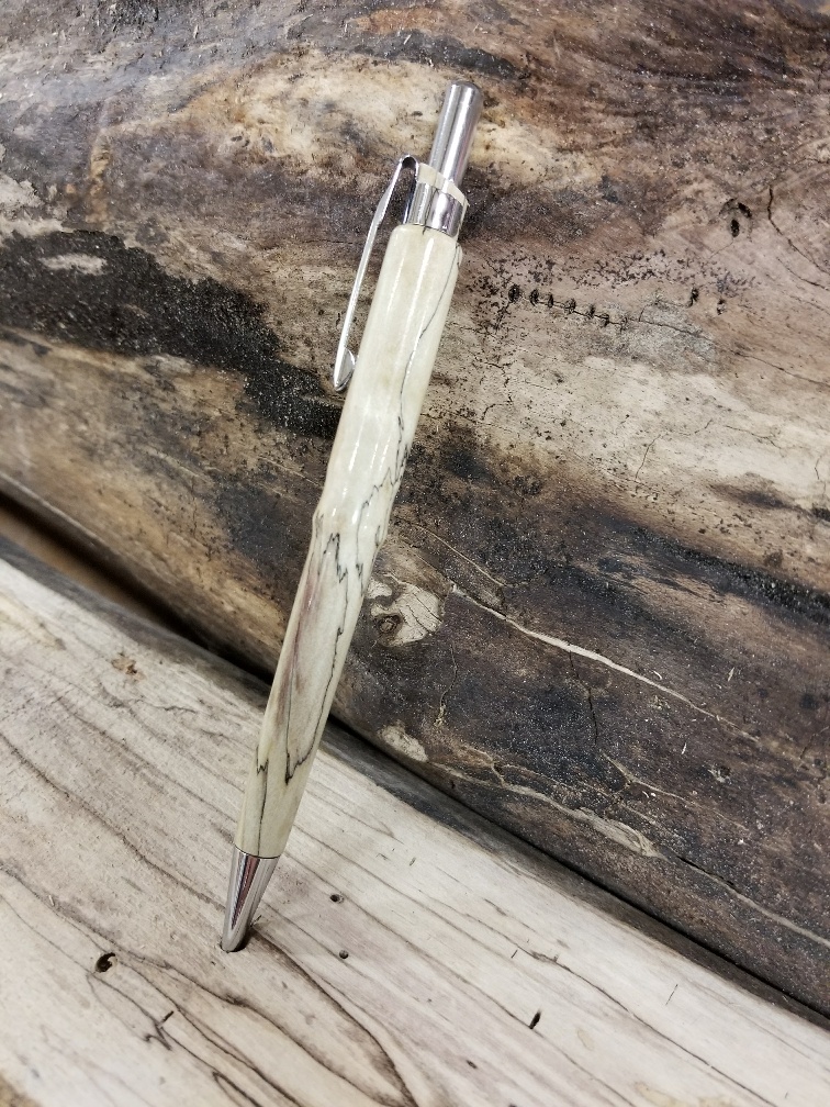

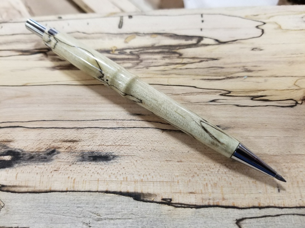

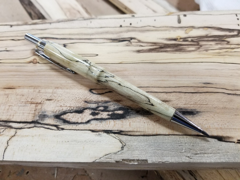

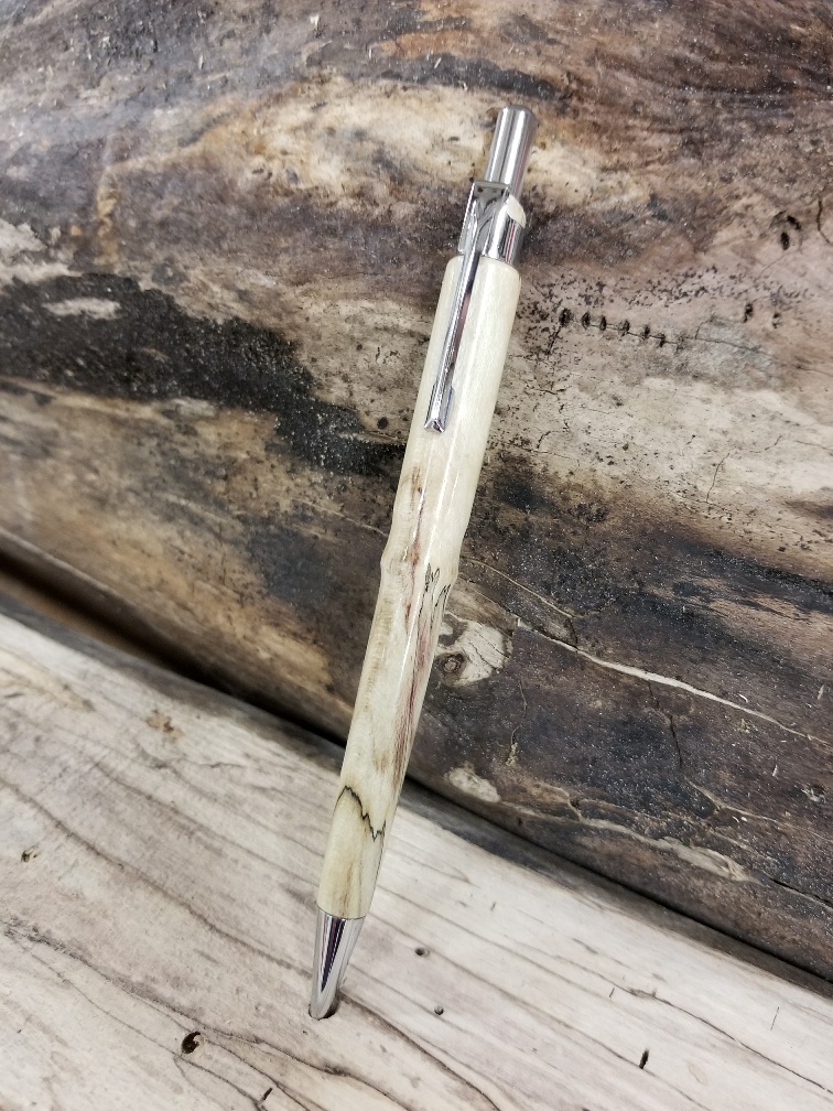

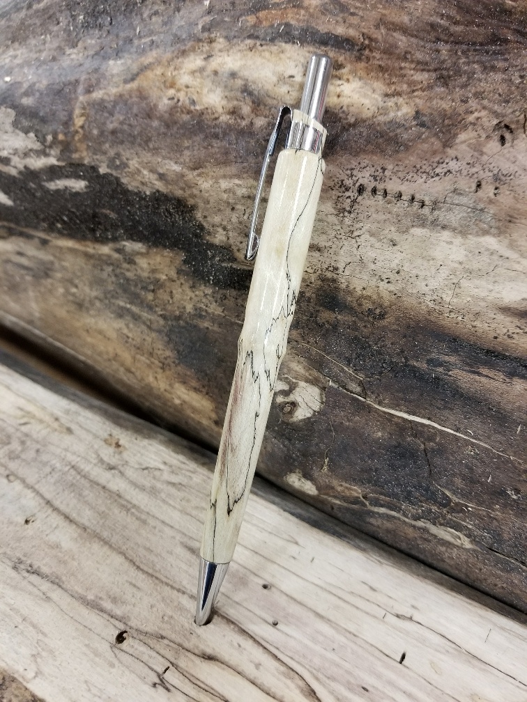

First project!
I stabilized some of the wood into pen blanks. I tried to die it with a blue tint, but didn't get near enough die in the CJ. The wood does have a very faint aqua tint to it, but really can't tell. So the die job was a bust, but this 2mm pencil turned out nice.
CA finish

Can you tell me a bit about the log to pen process. I have some found wood and am interested in the steps.
Drying, blank cutting etc.
Beemaker
Note: you might want to wear a mask as breathing the dust may or may not cause health issues before it is stabilized.

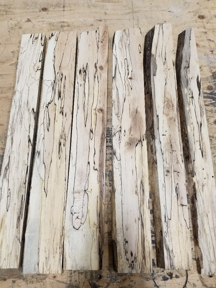

I ripped the log in half on band saw, then I can cut into 3/4" x 3/4 x 5" blanks on the table saw (or what ever size you need). My wood was dry already, but if it is wet from rain or what ever, let it air dry.
Then I placed in my vacuum chamber with some Cactus Juice and drew a vacuum until all the air was out of the wood and replaced with CJ. (in some of my pieces it pulled the ants out of the wood also )
Then baked @200f for 2 hours. - ready to turn.
Hope that helps
