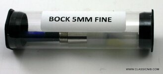

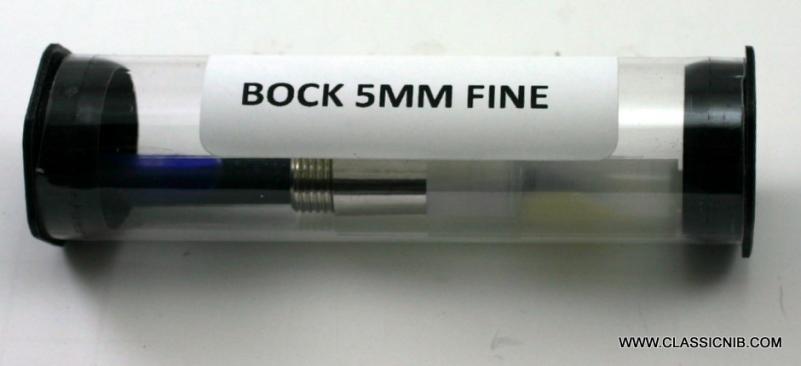

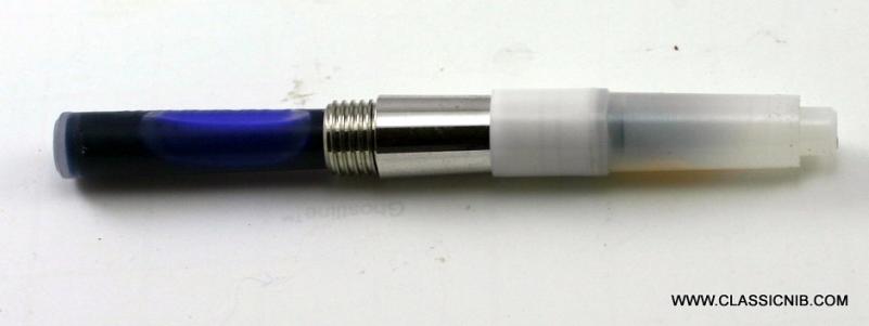

I'm a believer that the customer wants to and needs to feel the pen that he/she is interested in and try the different tips that they would prefer. I carry these in the 3 5mm sizes that I stock in 5MM and 6MM, when a customer is interested in a certain pen I ask them if they prefer a fine,xfine or medium nib and then just install one if these that is ready to write (now all I have to do is clean these at the end of the show when I get home) The customer gets to try out THEIR pen instead of a sample pen and gets to choose their preferred tip.
To change the nib only here is a video that I did to show how :
CLASSIC NIB - videos
If you are worried about the nib fitting the existing "kit" feed, Miester Nibs makes both a #5 and a #6 nib and feed set that will screw directly into the nib housing of both the Dayacom and Berea. Most replacement nibs fit the feeds without issue. The only time I've had this be an issue is with a PSI set. BUT the Miester nib and feed still worked.
The feed housing that comes with these Miester nibs has a shoulder than must be turned off in order to use that feed housing, but I've not had an issue with any #5 or # 6 kit pen using the Miester nib and feed, along with the "kit" feed housing.
