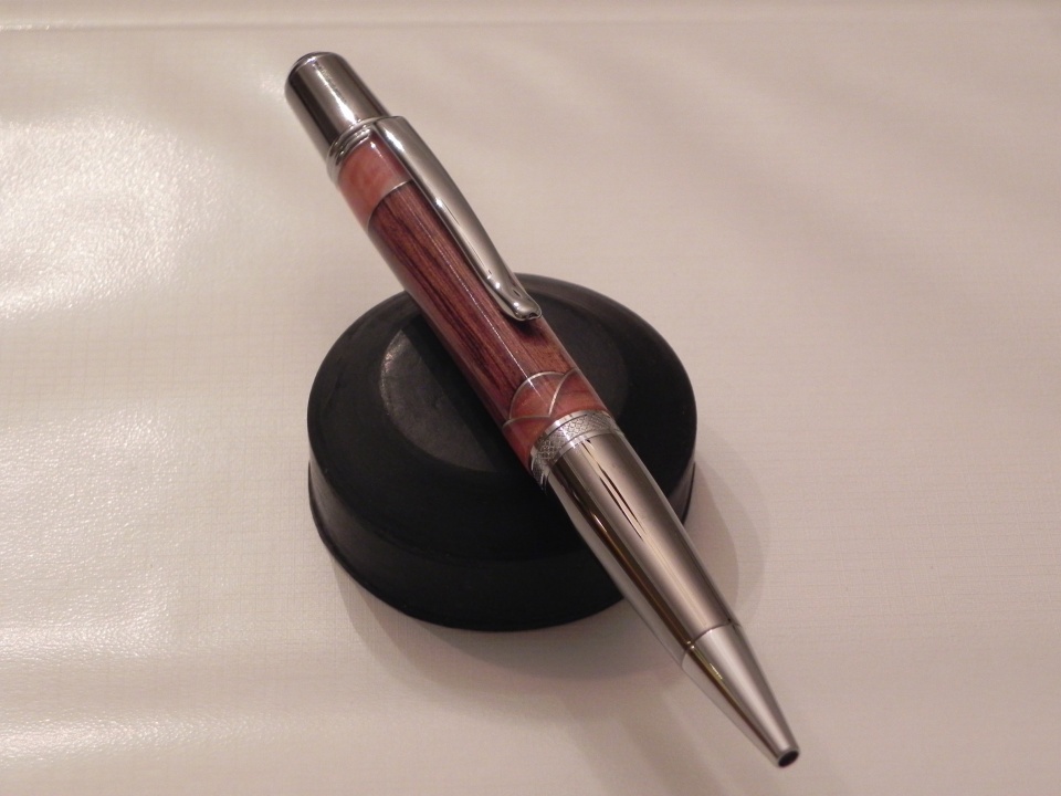

I have used aluminum rods that were cut to width. Most of them start at 3/32" and have gone up to 1/2" in width. I didn't have any problems drilling or turning them, but I made sure not to get them even warm. I used oil when I drilled based on suggestions from several people.
You can see some of the pens I've made with aluminum if you click my link.
Pjohnson, thanks for the good tips and the picture of that amazing pen. I am still waiting on Amazon to deliver my chuck but hope to try some soon.
